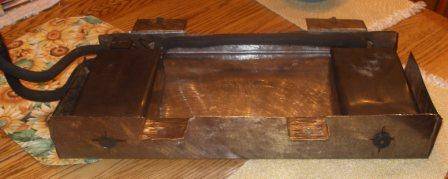

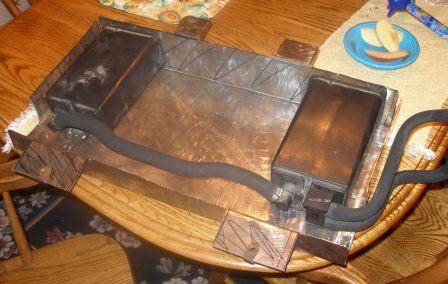

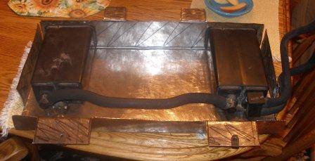

I will be building my prototype after work tomorrow, I think I might narrow it up a bit and move the canister a little closer together. I can't see a single good reason why they had them so far apart.
Heres what I whipped up after work, its a little rough and I did it quick. I will clean them up if I build more of them.
looks good but you better put some holes in it or its gonna get water in there and have no where to drain! i would also coat it with etching primer and then maybe a undercoating of some kind or a very durable outdoor paint for metal, maybe even patio furniture paint. looks great though!
