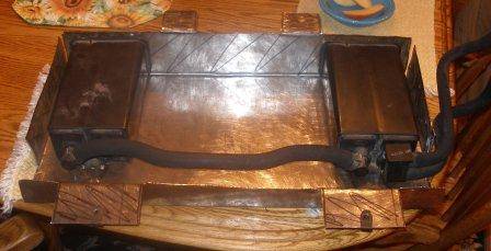

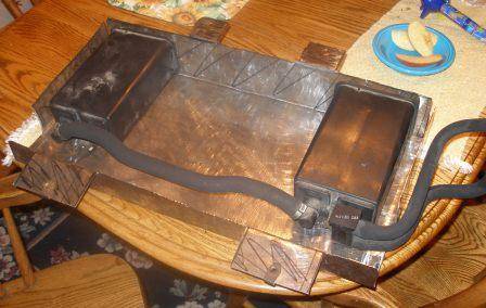

Under Body Canister Tray on 97-98 mark VIII
I got a new one from my local Lincoln dealer a year ago the metal is pretty cheap, it was new but had rust starting in spots where the original coating had come off. I stripped and painted with Imron, let it cure for a month then waxed the crap of it. I also replaced all the rubber hoses, they were nasty.

is there an ETA on this part yet? My canisters are now about to fall through. hoping to be able to purchase on this friday.
Heres the deal, I've been trying to get some time to work on these, but work and school are taking up all my time. I ahve my ap calc test and final paper for english due this week. After all that is done I will be free to spend much more time on this.
hey man i feel you...studies come first. i'm going to try and find a way to temp fix the problem until you get some free time. :cool:
any word on this project yet or does anyone have an extra tray that they can sell me as my canisters are now hanging through the servely rotted out tray. :eek:
Perhaps a wire wheel on a drill motor and clean off whats left of your tray. Then silicone or pop rivet a flat sheet or strips of sheet metal to the cleaned areas of the tray as a temp fix, till the "kid" can make you a kick ass replacement.

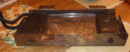

I have one that is half done, shouldn't take me more than 20 minutes to finish it up, and I will try and get a few mroe done.
