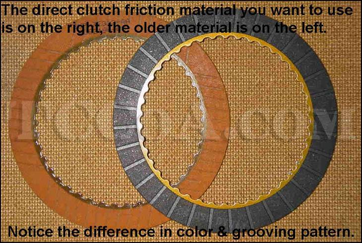

I guess my main problem with the pre-98 trans would be the accumulators and springs being crappy and the friction material.

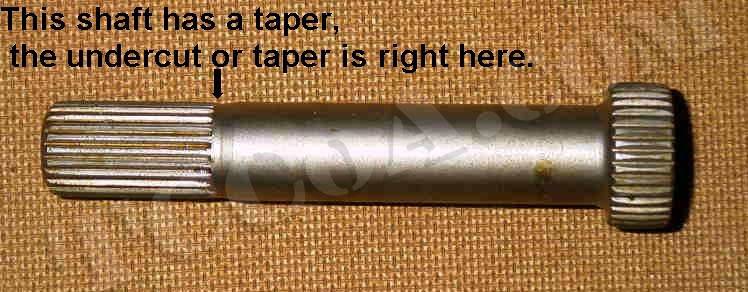

Another part that was updated in 98 was the little shaft that connects to the forward clutch cylinder. The shaft with the taper is much stronger than the shaft with the groove. The shaft with the groove tends to break at the groove.

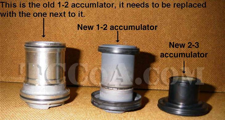

Now, accumulators side by side.
Instead of the little thin o-rings on the older accumulators, now the seals are rubber bonded to the steel part and giving you a hell of a lot more seal. I also think there was a spring difference too because the earlier years were breaking. The springs I bought from Ford were purple and blue and he said they were the stronger updated style. (Just going by what the parts dept. guy said on that one.)
