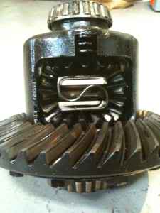

Well we went out in Brandons mark and "tested" the track lock he just put in. It was SOOO much fun. :gr_devil:

I have been thinking of my options for locking it up. which one did you guys use? Any other options that you looked at? I need to do some shopping so any info would be great.
any 8.8 will work. the only thing you need to worry about are the gears, as long as your not changing the gears you have no differences to worry about
Any 28 spline t-lok will work. 31 spline ones will not work.
okay so any 28 spline 8.8 will work? and what gears would someone recommend for only slight engine upgrades like a corbra intake, air intake and exhaust. I am planning to install a low stall converter as well at some point in the future.
Thanks for the help as I dont have much experience in rearends, like some of you here do:shifty:
If you are staying all mothor then 4.10's. If you are gonna supercharge then 3.55 or 3.73
