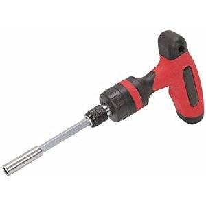

Show a pic of this T-handle tool.

Mine is like this and acts as a ratchet but with a T handle and my flexible extension is 18" long and takes bits and or a 1/4" adapter on the end which would hold the socket needed for the IAC. On the T, I can slide a little button down to reverse my turn or forward it. At the moment, mine is still out back under plastic, inside a toolbox that hasn't been brought into the garage since the fire. The below pics give an idea of what I'm talking about and it makes and IAC swap extremely easy.
Now, you would take the extension, which is flexible, put it onto the T handle along with your 8mm socket and come in from behind all that crap in the way and at the same time, you can use your right hand to hold onto the bolt that's being removed. I always go back with 2 of the same bolts and not the one with a nut in the middle of it. I also use some that are a little shorter because what they put in there are stupid long and not needed. When I put the new IAC back on, I first put a drop of elmers glue on each end of the gasket to hold it in place so that I can easily get the new bolts started.
When I get all this junk out back uncovered and cleaned up, I'll get a pic of exactly what I have but the above is basically it.
