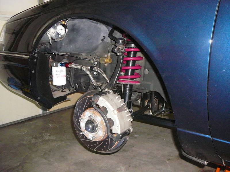

It would be cheaper just putting a Accusump in it lol.
