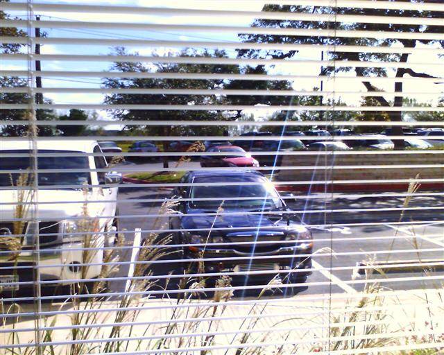

Enough ragging on StinkinLinkinLS01 - it's actually a shame that another LS owner in Austin and I can't hook up on the projects.... (and I share the blame)
just for the record - it's sitting outside my office window right now....

Im new here, just found this place the other day when looking for exactly what you seemed to be working on. A Supercharger for my 2000LS. I have been reading backwards out of the anticipation to see the finished progress & I see you mentioned a possible price tag of 4500 dollars. Id just like to say, Id pay it. Would be a damn nice addition to an already damn nice car.
MAN!!! I've been gone for awhile and hadn't seen the finished product yet. Outstanding work Lou!!! You must have engineering in your blood.
Very nice pic Lou...the intercooler does look very definitive and menacing. I'm not trying to bash ya...just really interested in seeing more pics and some actual stats thats all. I know no one else is in too much of a hurry but I'm all about performance so I of course wanna know what that thing runs and what its dyno sheet says! Again Lou...excellent work thusfar...keep the pics coming! Just like your sig says...

Couldn't you have at least done us the curtousy of stepping outside for the pic?
Those blinds suck!

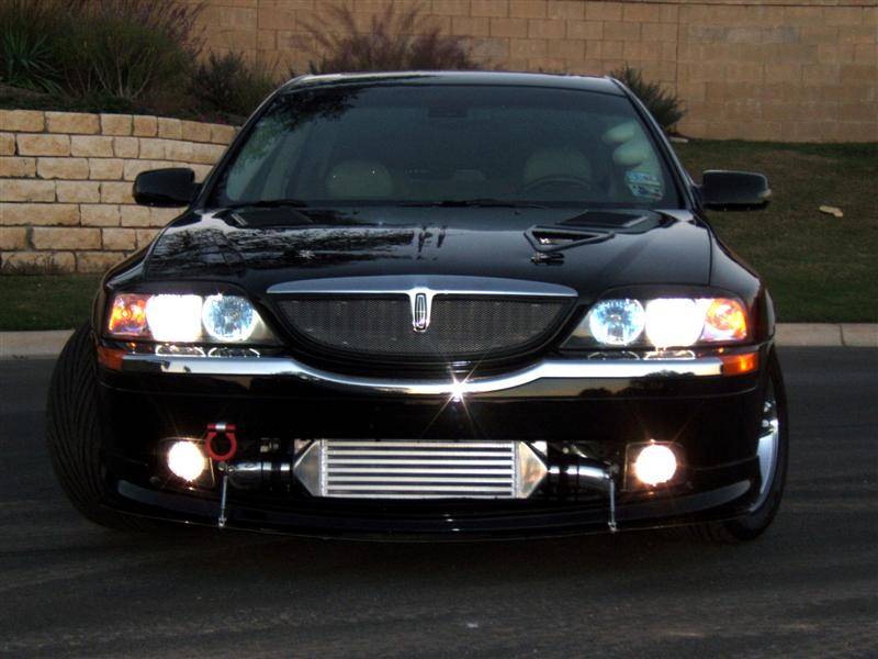

here is a more recent pic (last weekend) taking pics for the 2007 LLSOC calendar....
