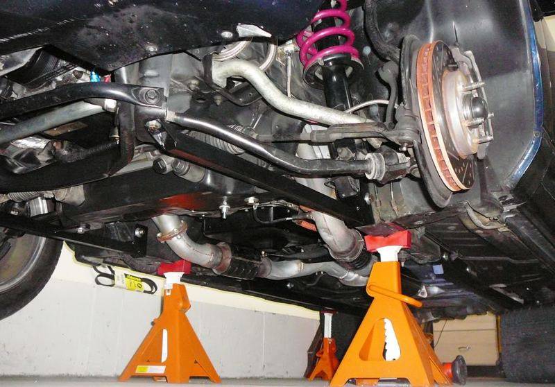

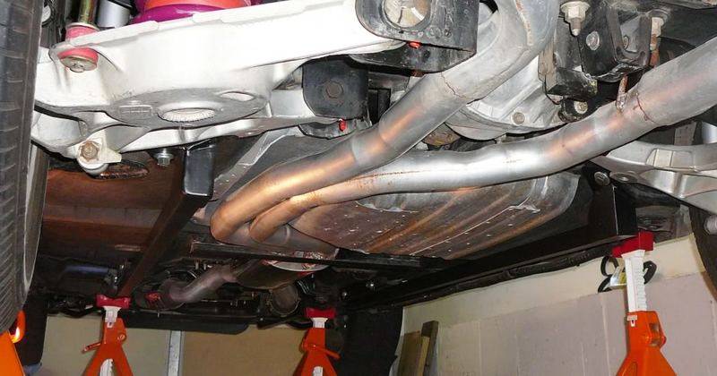

I made these a while back. 304SS

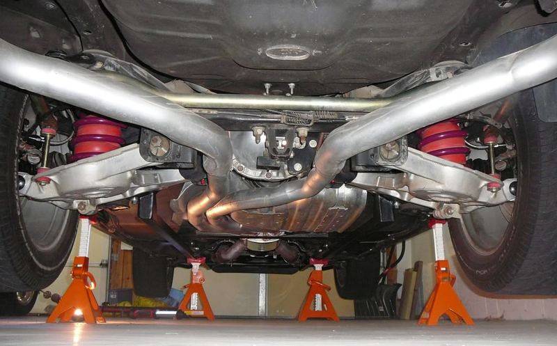

Here you go.

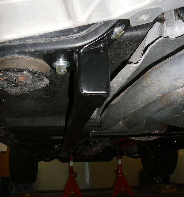

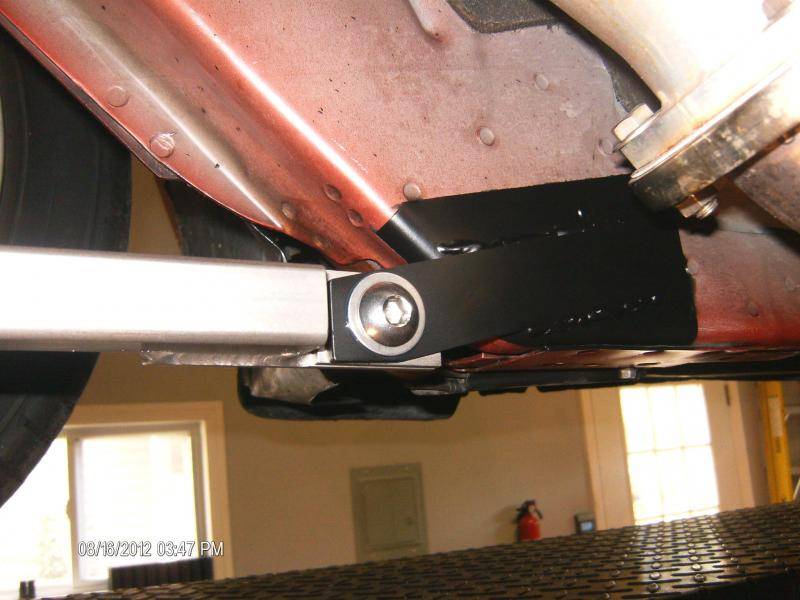

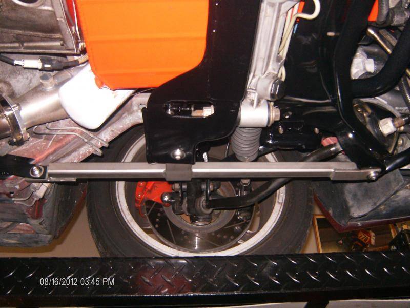

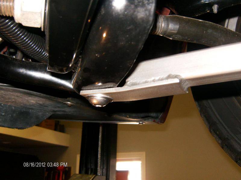

K-member to frame connectors:

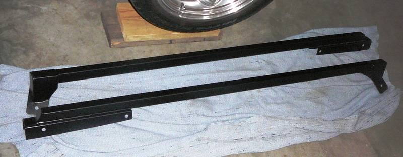

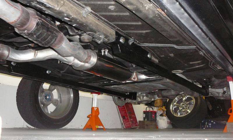

Subframe connectors:

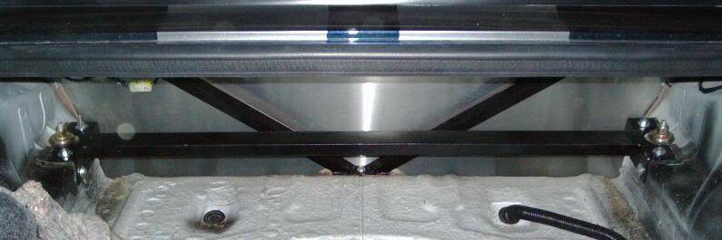

Rear Shock Tower Brace and V-brace:

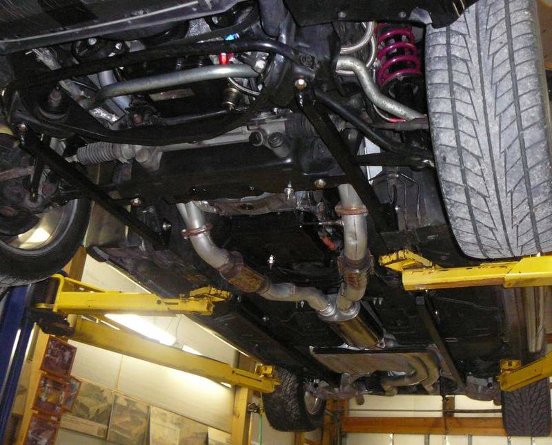

Underside pictures:
Good God. If there ever was a mark for auto cross or jumping on turnpikes quick DLF'S mark is the best. Great job man, that's impressive

Racecougar : did you notice any real difference with the rear shock tower brace?
Hey Rod, You do know that those shock nut tabs should point up, right? ;)
:lol: They can, or they can sit that way, too.
Every little bit helps. It does make a noticeable difference, but the big players are the subframe connectors and the K-member to frame connectors.
