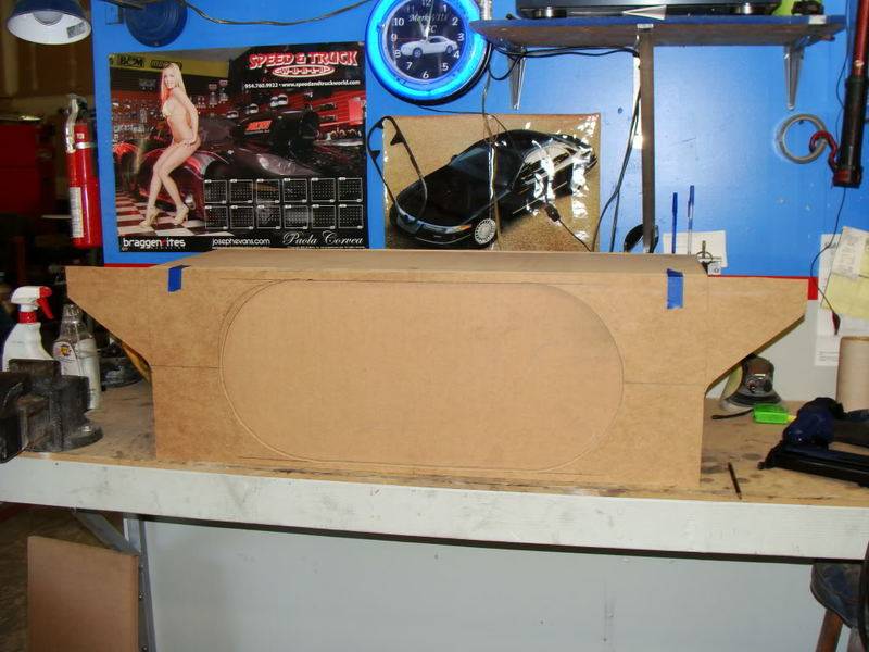

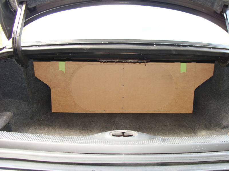

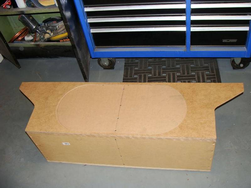

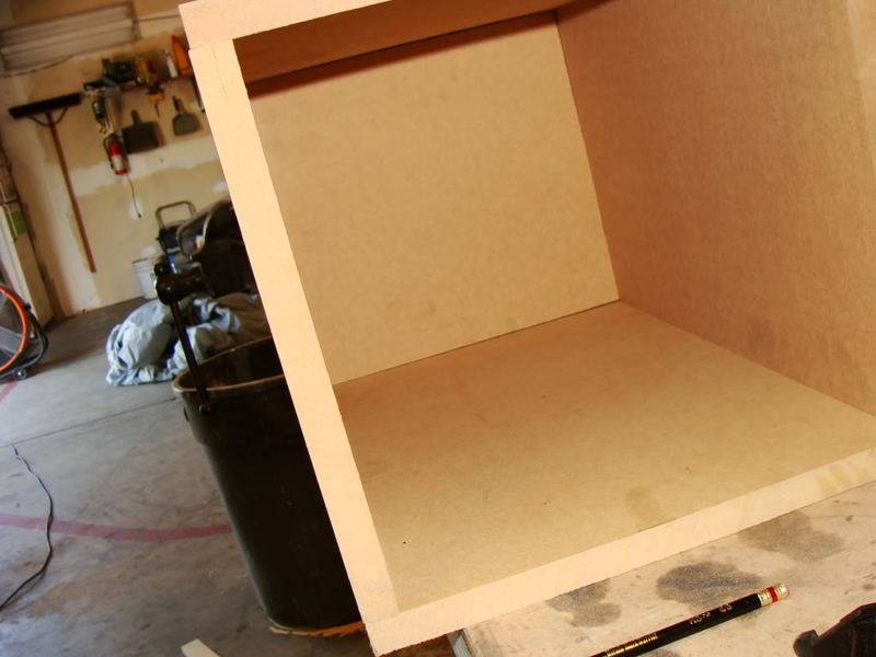

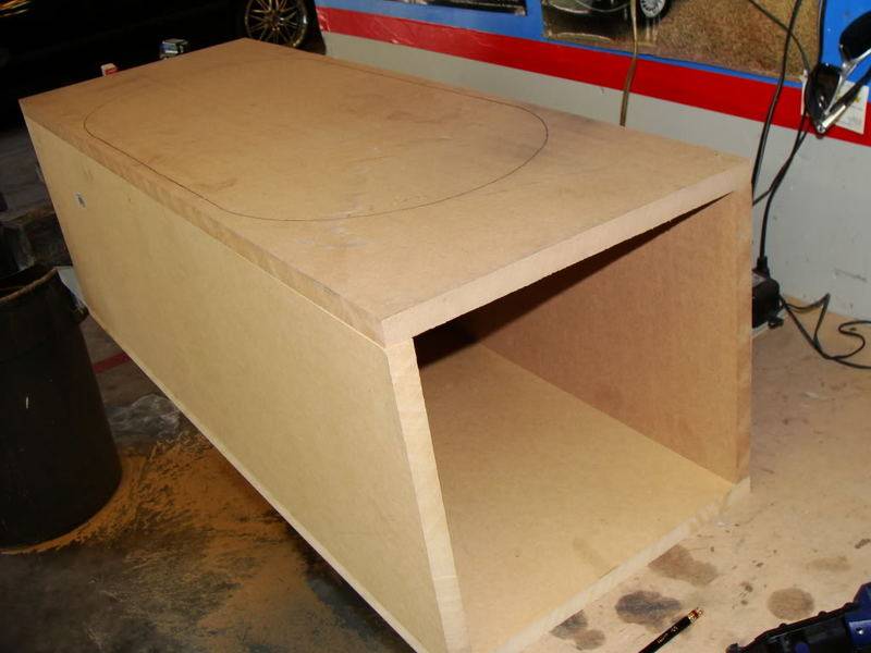

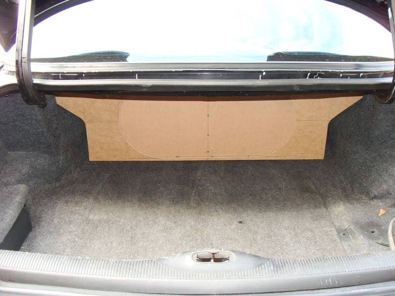

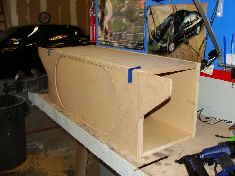

well, not really, just made my sub box. it isnt finished, its built, glued and screwed, sub holes not cut yet, and the carpet isnt on, but its done as far as building it. what i did is built it a hair bigger than minimum air space needed, it is sealed not ported, its 36" L x 13" H x 12" D with a divider smack dead in the center. its all 3/4 MDF that i pre-assembled with my pnuematic brad gun then went back and drilled and counter sunk coarse drywall screws. normally i make these fast and sloppy but i took my time and the box came out mint, all my cuts are dead straight, the joints are all tight as hell and i sealed the inside up with ALEX clear latex silicone caulk. the front panel is 1/4 inch MDF and will be covered in carpet, i have carpet to match the trunk carpet, the front panel is just a filler so i dont have an ugly basic box in the trunk, the filler is cut to fit the contour of the trunk inside, see pics, only the face of the box will be covered in carpet where the subs mount, then the filler panel will be covered in it too, and will attach to the front of the box with velcro strips, so it can be removed if need be. i still have to carpet it and cut the holes for the subs and wire the inside, i'll do that this week, i just did this today in between restoring more headlights. i am in no rush to get the system in the car so i am taking my time, i have everything to do it, i just need power and ground wire to finish the list, but i can get that anytime.

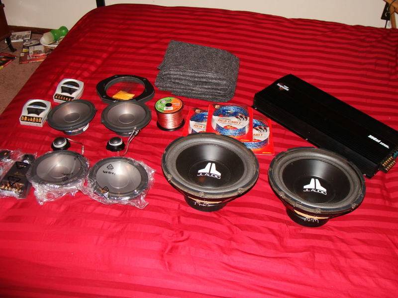

here are some pics.

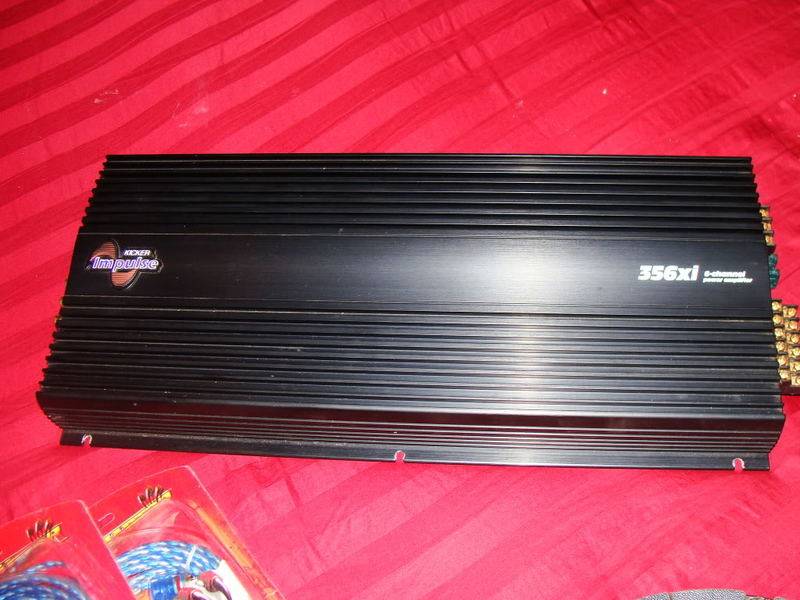

here is the rest of the stuff going in, i already put the Kenwood eXcelon KDC993 in the car, it has to come back out though for the wiring. thanks to terry ( nolimit95 ) for the subs and amp. we worked out a little trade off!
i'm not going into too much detail about my amp location until its done, but put it this way, the spare tire will never fit my car again with the cobra brakes, so hmmmmmmmm, wasted space?? you'll see!!

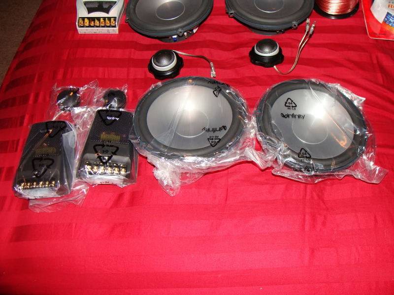

bill i bought two pairs of infinity components, i will have then in the doors and the rear quarters. the mids will go in the door in stock location, and the tweeters will go in the stock location also, in the rear the mids and tweets are going where the stock ones are as well. the plastic 6x8 plates you see in the pic, the black ones, are just to change from stock 6x8 speakers to my now round 6 1/2 mids.

Yeah, I see two pairs but isnt one set Kappas and the other Refrence?
nope they are both refference, one set is used and last years, infinity 6020's and the new ones in the package are 2010 infinity 6030's
Ah, my bad. Tough to keep up these days. I feel old. :(
I see they gave them a Kappa size voice coil this year..... or just a bigger dust cap. :lol:
Fuggin stuff, used to run the same thing for a few years and now its every 6 months a new design comes out.

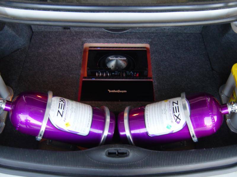

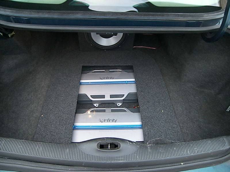

Here's Mine

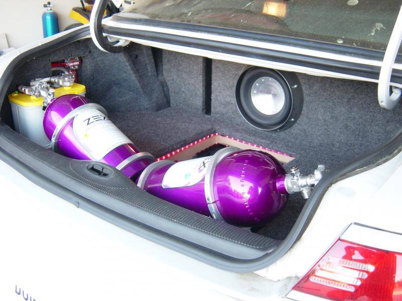

I'm still waiting on the mirrored and clear Plexiglass. It will go under the amps and bottles, with the clear over the amps.
Rockford Power T1? Nice, those things really slam. Did a 12" in my 86 300Z and it way out pounded my friends 13W7 in an identical box.
Oooo, I gotta take some pics of mine. Two kicker CVX 12s, Planet audio BB2400 d class, alpine 5x7s, Boston acoustic 3way components and a Memphis PR4x50.
