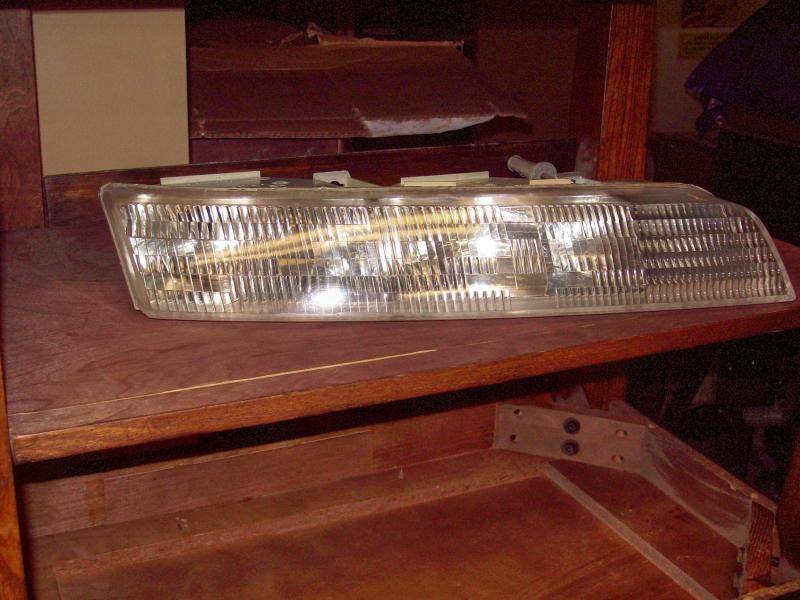

Went to the junkyard yesterday and picked up a set of headlights off a 93 mark. Pretty decent shape, a lot of yellowing and the chromes pretty much shot. Decided to cut them open, re chrome them and get an HID kit. This is gonna be for my dads 95 mark. The guy at the junkyard gave me the whole header panel with the headlights, so if anyones interested in it I'll post some pics of it and make me an offer. As of now I have one headlight apart, I took like 2-4 hours and make the lens clear. Goin today to get some chrome reflective tape, silicone sealant and meguiars plastX compound. Should be a good project, I'll try to take some pictures if I remember. He wants an HID Kit that will be white, not blue, so 6000k is good right? Hopefully I'll get some pictures up, hardest thing so far was making the lens go from brown to clear lol. Anybody use high heat chrome paint like people use to paint things chrome on the inside of their motor? Was thinking of trying that and if that didn't work just use the chrome brite or w/e it's called?

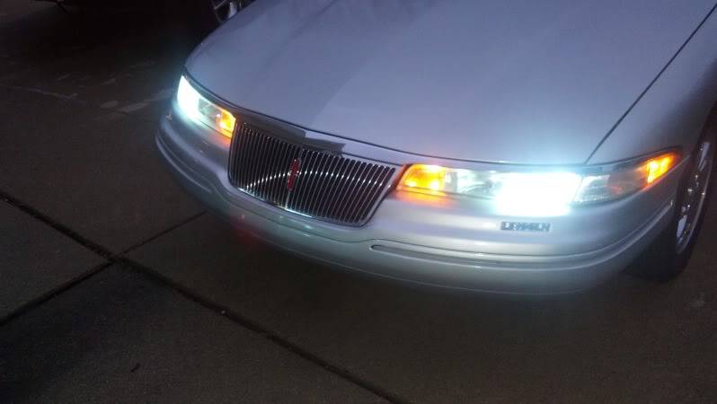

6000K is definitely the way to go here is mine:
Blurry pic is blurry but you can see that they are white
they do look a tad blue in this pic but they are truly bright white

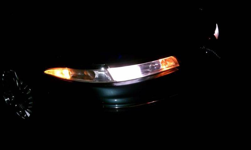

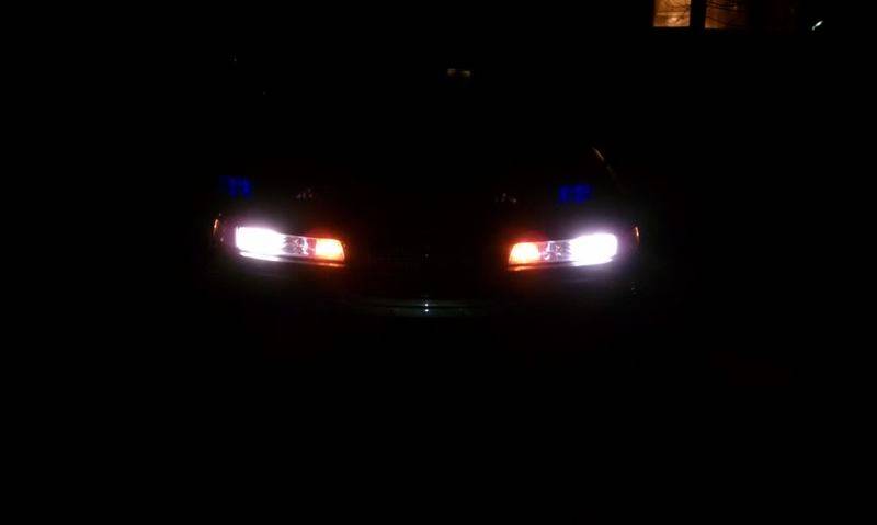

The 6000k hids I've seen look pretty blue to me, id say 4300k-5000k would be the whitest bulb you can get..mine are 4300k which are a crisp white..even the pic makes them look slightly blue but they really are white.

gen 1 lights
I found the best way to cut the lights is with the new vibrating tool. I used the round blade and it was perfect. I used it on my 2'nd set and it made the job easier, and it cut straight lines. Go slow so you dont melt the plastic. Leave the diverter in unless you want to light up trees,houses, and everything but the road. Get Chrome Brite not rocker panel tape. Side by side it's much briter It takes about 2 rolls +. The tape only bends one way, so you have to make a lot of little pieces. I gave them a light coat of clear to seal the tape alittle and still looks good after a year,running standard bulbs. I just installed an HID kit,nice all plug in. Hope it does'nt melt the housings. 8000K,75 watt Have'nt tried them on the road but against the garage wall they seem as good as my 98. If the yellow is'nt too baked into the plastic it will buff out with polishing compound Good luck TONYyyy
Thanks for the tip! :Beer I might just have to try that next time I try to mess with some housings. I do have a a couple pairs of gen-I non-LSC headlights lying around, but I haven't wanted to mess with them because both pair are in good condition (no damage; some yellowing on one pair, though, and the other pair is in "good" condition- not too yellow, but definitely not NEW either), and I didn't want to risk melting them in the oven like I did the last light I messed with.
