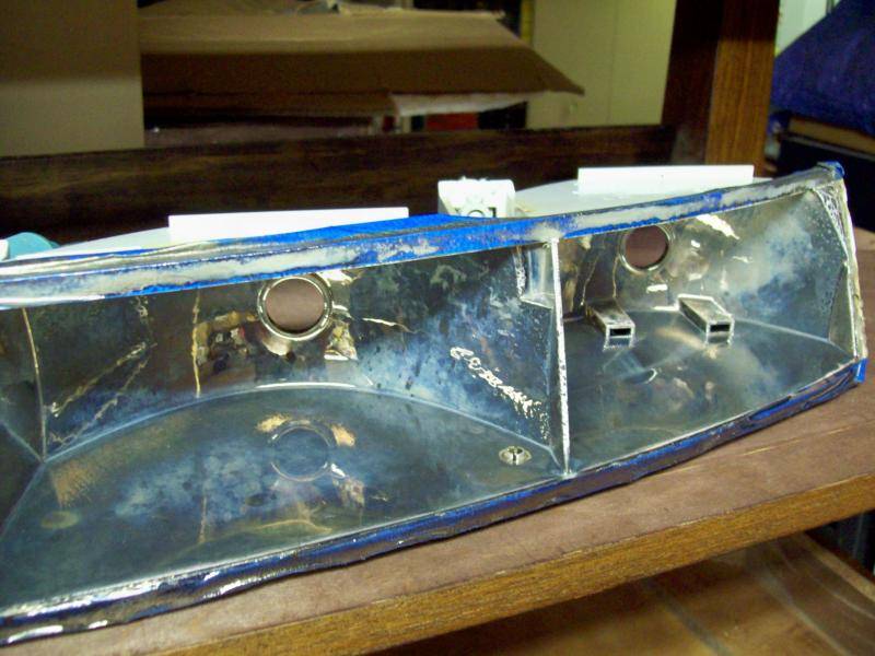

I got a chrome kit from a company in Ca called ALSA. They claim you can chrome anything even a pair of leather shoes. I invested the $300 and gave it a try. STAY AWAY it did'nt work for me even the second time with extra tips from the company. Their video looks like it'll work. It's just spraying a mirror and clear coating. The video sucked me in. It would have been perfect to re-do the lights. I tried to get a refund and after 1 year faxing and calling never got an answer. Watch their video and you'll see what I,m talking about. It almost worked

That's after the second try. The guy gave me a tip to wait 3 hours after I mixed one chemical. They did'nt put that in the instructions It almost worked Some small areas came out. I had to clean the headlights twice and got bad results. Taped over everything and they look great. I think it's still in the test stages with the 2 for 1 spray bottles There right outside of LA Vernon I think.
