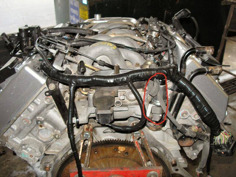

If it were me, I would go ahead and buy a new IAC and TPS and swap both while you're in there. Do the IAC while the TB is off. Makes it a little easier. You'll need another TB gasket and an IAC gasket which are cheap. The IAC can be from $40 to $50 and the TPS is about the same but it should cure all of your idle problems. If you do swap the TPS, don't forget to plug it in before you bolt the TB back down.
