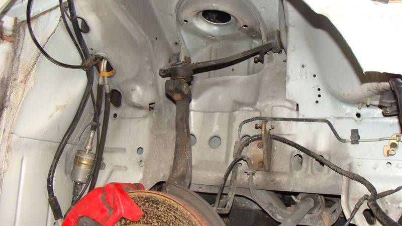

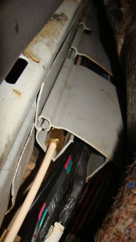

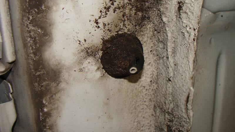

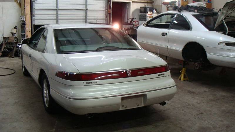

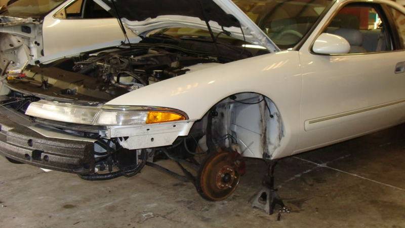

most of you read my other post about the 95 i bought for my wife. if you didnt read it, read it first then you will understand this. so the guy was gonna put springs on it, but for some unknown reason this is what he did to it, he ripped out the compressor, cut the height sensors off, yes cut them, and removed the ball studs too, he cut both front air lines going to the struts, and he cut the rear lines where they go through the pass wheel well. unreal, i dont understand why, and he is a collision man by trade, i want this tool working on my stuff!! here are pics i took as i went along, i spent nearly 6 hours putting the air ride back together. i put in a slightly used compressor i had, and 79k struts out of a 98, the ones that were in the car both leak. its all fixed, works perfect, and thank god that 96 is still in the shop ( air line doner car )

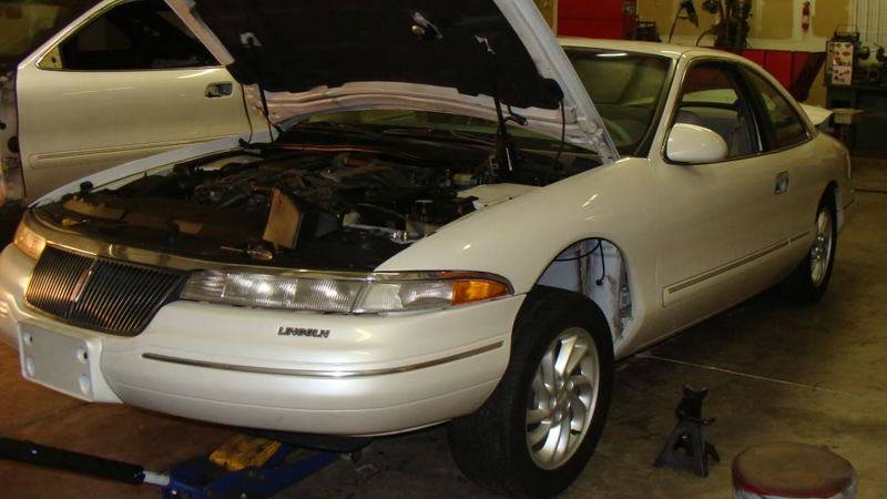

all i need to do still is put the vcrm in it, get a new radiator, and change a front abs sensor, lower the rear a hair and slap on some mufflers and put it on the road. i have to paint the driver side door handle too, its a brand new one in primer, easy enough. i got about $22 bucks into the car so far lol.
