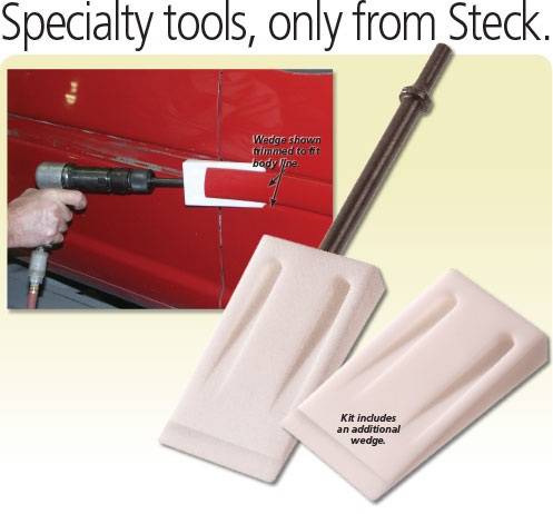

They make a tool that work great for trim without damaging it.
http://www.steckmfg.com/21542_EZ-Strip-II-Molding-Tool.html
These work perfect in a shop environment but if you are out in a u pull it yard not so much.

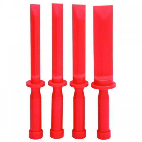

This...

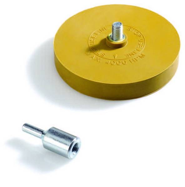

Then you want to get one of these...
Be sure to only use genuine 3M double sided moulding tape to install.
OK I'm having visions of "Ask This Old House" and their "what's this tool?" segment. So WTF is that and where do you get it?
It's a rubber 'eraser' wheel. You chuck it up on a cordless drill and use it to remove the remnants of the old adhesive.

Those 3m rubber wheels are a life saver. I took off all the old pin stripes on my truck with one of those, works great.
