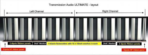

Or if money was no object.
I give you the Transmission Audio’s Ultimate. These speakers are so powerful they will knock a girls clothes off! At $2,000,000 a set the better! :lol:
Each speaker is over 8' tall.
