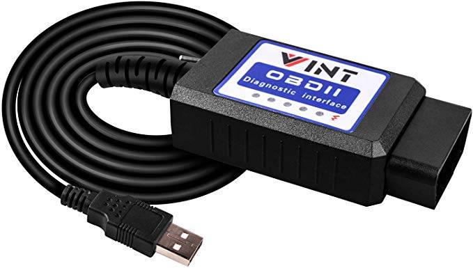

There are a number of things that can cause the EPB service message, and some of those have nothing to do with the parts of the EPB. Note that the EPB has a control module in the trunk, and actuator under the car near a rear axial, a couple of cables (including an equalizer), and of course the parts on the rear calipers. A weak battery, data bus wiring issues, some PCM faults, and even a failing DCCV can all cause EPB faults. Assuming that you don't want to randomly throw all those parts at it till it is resolved, you will want to do some diagnosis on it.
To start the electrical diagnosis, you need a scan tool that can read the EPB DTCs. Most can't. The Windows version of Forscan can do it. The software is free, but a $20 or so OBDII to USB adapter is required. It needs to be one that works with Forscan and has the switch to choose the low and high speed buses. The codes that you get won't tell you the problem so much as what to test to find the problem.

FWIW Forscan App is free on Windows computer...the adapter is cheap
$18.97

FORScan OBD2 Adapter, VINT-TT55502 ELMconfig ELM327 modified For all Windows compatible with Ford Cars F150 F250 and Light Pickup Truck Scan Tool, Code Reader MS-CAN HS-CAN Switch
Thanks man I didn't know if that's what it was i was looking for i did see that..and that will basically work with any obd2? ..also are there any other steps or advice you can recommend doing? im currently gonna be flushing out heater core and coolant system my DCCV was so shot and so clogged(heater never worked when i bought the car never bothered me til i moved out of cali to freezing ass MI!) lol..thanks man all the help is so greatly appreciated! love this site!

If you truly want to flush the system really good yourself I suggest using Distilled water and filling up the system a couple times and opening the pet cock and letting it drain ...otherwise they're is flushing machines at shops that will flush it professionally as you prolly know ...the Forscan app can recalibrate your ABS system which basically marries the ABS system with the PCM also the Lateral steering/Yaw rate sensor can be recalibrated ...as far as the Parking Brake goes it will let you know what the problem is...whether you have a shorted wire or something more serious...you can press the brake in and turn the EPB on and as you let go of brake you can turn it off in order to reset it...you must do this everytime the battery is disconnected
.. maybe thats whats wrong right now cause its been beeping extra obnoxiously since i replaced the battery last week ..will disconnect the battery again and connect then i will try and "reset" the EPB thanks for the great advice
** hey guys that actually seemed to help quite a bit! havent drove my car for more then a couple blocks and is all take apart right now but in that drive it would have normally been beeping constantly but was fine no warning no beep the whole time..thanks for the great advice!
