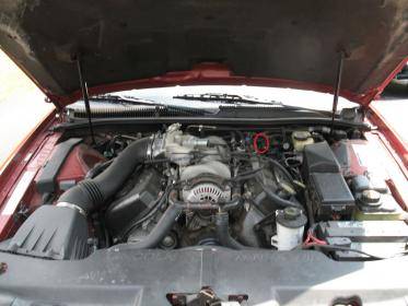

I have never done the seafoam thing and to be honest don't know where to pour into to get the best result for cleaning the intake, cats, and o2 sensors. Doing 1/3 in gas tank and all the rest in the intake. If someone could send some pix of exactly where so that I don't fudge it all up. This is my daily driver and due to privacy rules in my apartment complex I will b in the boonies. So must a must get it right the first time. Lolz

I do mine through the pcv. It's on the drivers side valve cover in back. I usually put half the can in a seperate container and let it suck it up. I then put the other half in the tank.
It might stall out really easily or it might take half the can like a champ.
K so pull the PVC valve out and that hose is wat I let suck up the seafoam correct.
Yep, and like sbcaprice305 said, get a bowl or another container that you can put the seafoam fluid in. Can't do it straight from the bottle. I tried to look at a pic online but couldn't find a close up one, so here is the general area. (Red circle)
The bottle opening will fit over the pcv, but it's alot easier doing it in a seperate container.

K I know wat to do just get a small container put half or alittle more and disconnect the PVC valve and use that hose to suck up all in container. Does it matter on idle or do I need to rev the engine during because its only me by myself. I will need to rig up something or just stay on the idle cable
I leave the pcv on the hose. Do it at Idle. If at first it starts to bog badly stop and let it get back to normal and then continue. Once you get to the last bit you can let it suck till it dies if you want. Let it sit 10-15min and start it up. You can drive right away or rev it, just be sure to get the revs over 3k so the imrcs open up.
