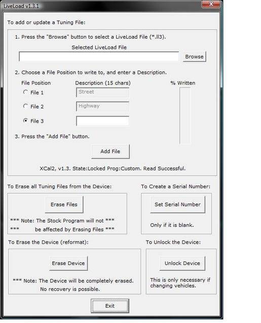

finally received my tuner today... got the uploads i needed to get it on my computer.. here is the screen shot of the liveload program.. the unlock button is not greyed out so that means i should be ok ... correct??
give it a try.... click unlock then plug it into your car and see if it works
Will have to do it when i get off work... was on my lunch break at the time... usually when its locked it will grey out the "unlock" button??
pretty sure but not 100% Like I said though... the only real way to know if to try it out.
