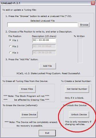

guys - LiveLoad v1.3.1 can unlock the XCal2. It's free.
Are you sure?
If the device is unlocked that button is 'greyed out'
