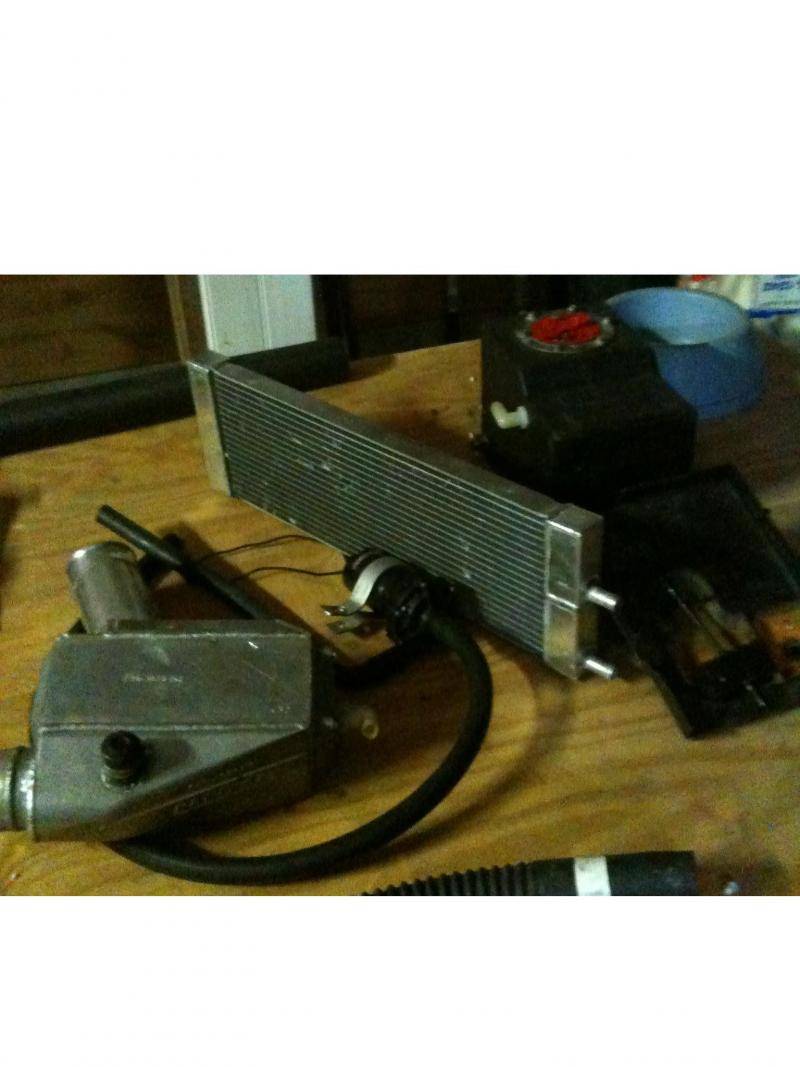

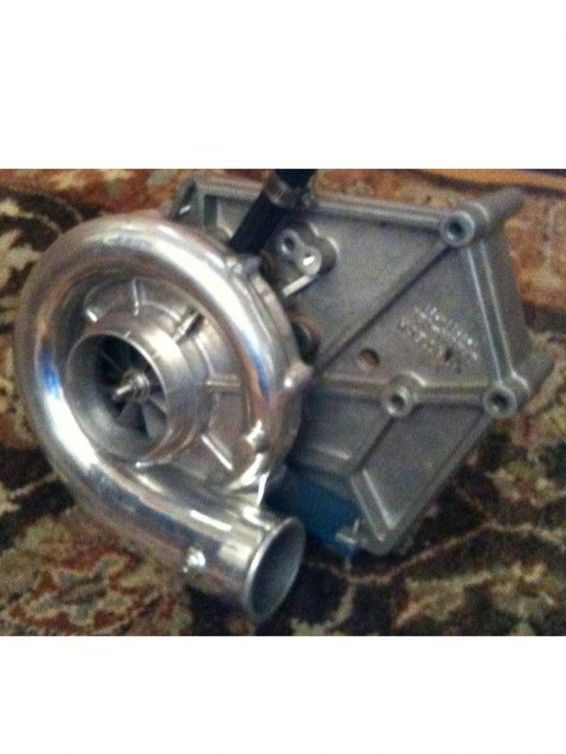

Ok so I pretty much have most of the parts now Sorry about the pictures I don't no what the hell I did there
Clean, It takes time for a centrifugal to spin up and produce boost, this takes RPM's and time, keeping the IMRC's will help with low end torque and make for smoother boost. If you were installing a roots delete would be the way to go.
Fastmark it's a centriv blower looks like a s-trim. Vortec either way. To the op what psi do you plan on running?
