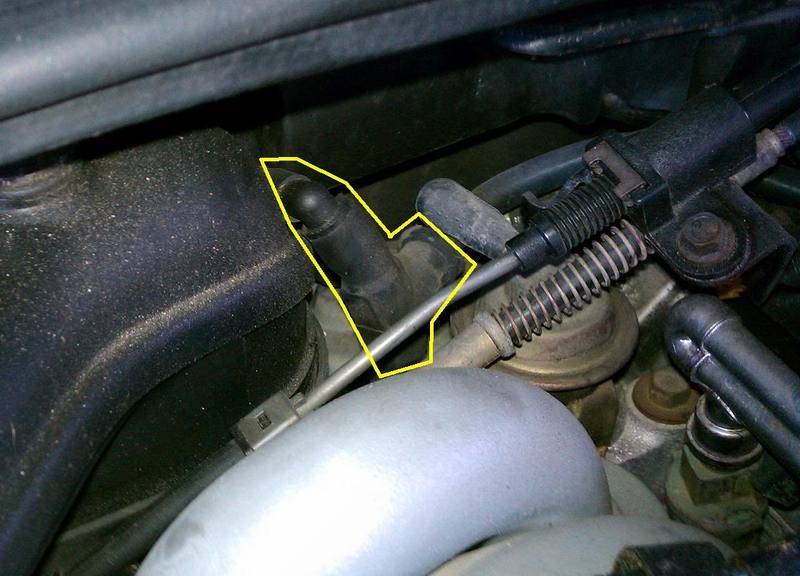

Ok guys, took a look @ the T-fitting (circled in yellow) & everything looks normal, everything's plugged in, etc... where's the IAC? Can someone help?
IAC in that pic is behind the intake tube, on the back side of the motor, attached to the throttle body... Good luck and godspeed if you're gonna change it.
Holy fvcking sh!t are you fvcking serious?:Bang
Who has done this before & what should I expect?
Ok so remove the intake, get that sh!t outta the way & look for what? + how does it come off?:confused:

Take the Throttle body off and you can get at it .. Throttle body comes off pretty easy.. You can take off the wiper cowl for more room if it's a problem.
