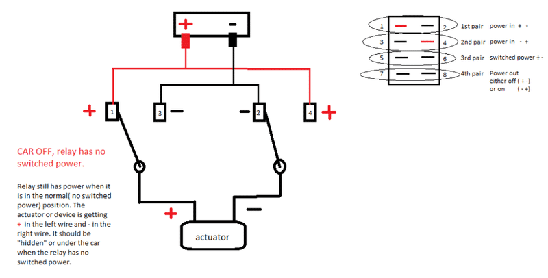

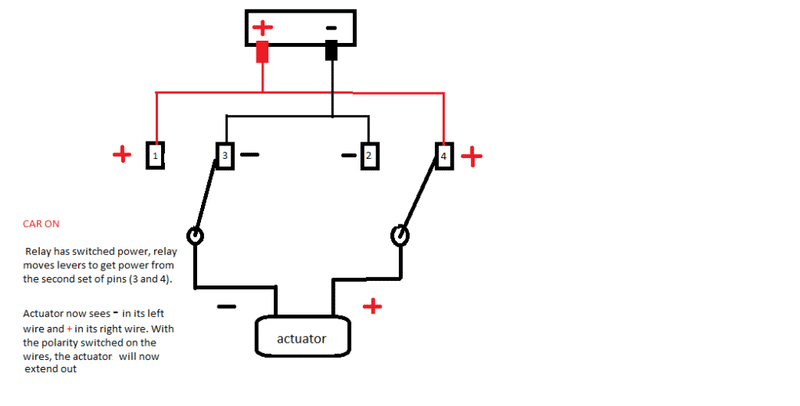

If you could draw a diagram that would be helpful!
The relay will alway have power, thats why you need a dpdt relay, double pole double throw relay.
Alright thanks for clarifying
Searched the dpdt relay got a variety of different kinds. Any certain one you recommend?
I think I got mine at radio shack. Which one are you looking at?
Basically like this. The location of each pair of pins might be different, but there will still be 2 pairs of pins for power in, 1 pair for power out and 1 pair for switched power(activates the relay). So long story short, for the power ins, first pair of pins have the power and ground wire one way, second pair is the opposite to switched polarity.
