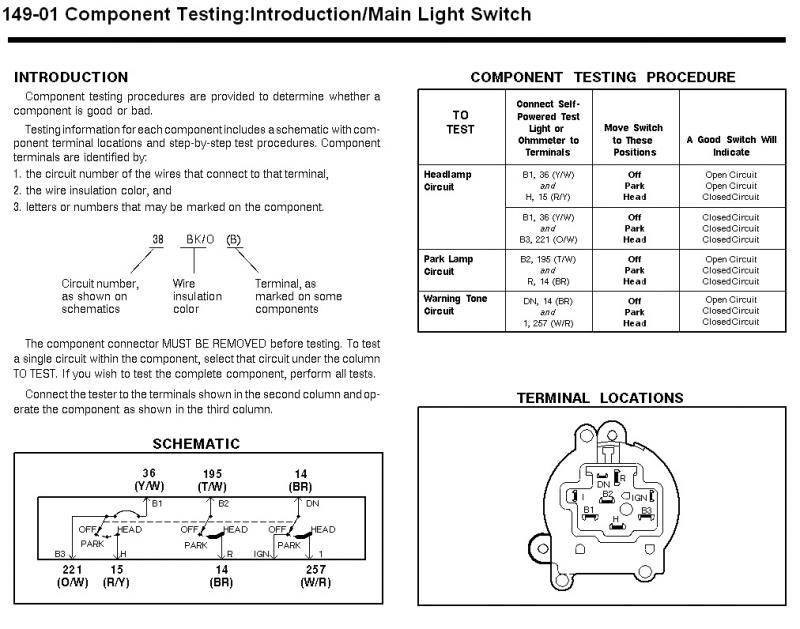

I thought I attached this with my last reply, guess it didn't work.
Here's a page to test the switch from the manual:
these and alot of ford headlight switches from the same era had problems with the switch and the connector melting, pull the switch and inspect would be my next step. remember fire bad.
