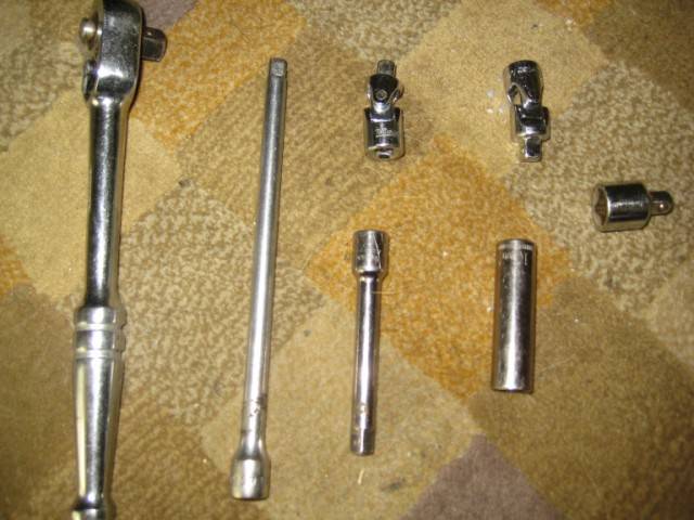

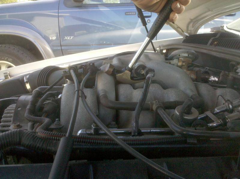

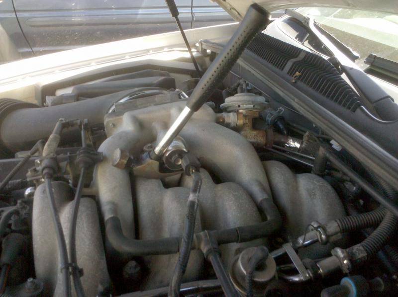

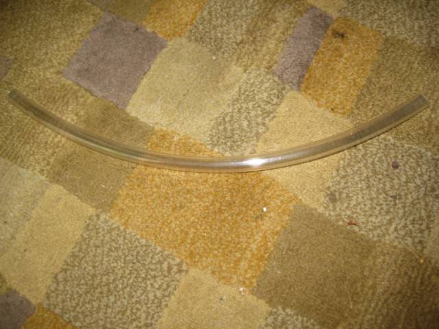

I just figured I would go ahead and make a new thread for this subject. The title should pop right up with a search. Hopefully this will help someone down the road and they can use the info:
When I did mine, I was scared it was going to be a real pain. I used a 1/2" ratchet with the 1/4" adapter. What I used were two swivel connectors, one at the end of the first extension and one at the end of the second extension by the socket. It really worked very well. Took me about a 1/2 hour at the most. To put the screws back in, I used a 12 to 16 inch piece of hose that would hold the bolts. It took a little finagling, but wasn't bad at all. Hope this helps someone. I have a 96 LSC, I don't think that should matter, but it might. Good luck!

Don't remember what intake you have, but if you've got the gen1 style remove the throttle body first - gives you a lot more room!
Actually I didn't have to, It would definitely give you more space and make it easier. All I removed was Throttle Body Tube and that was it.
