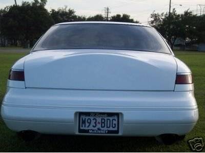

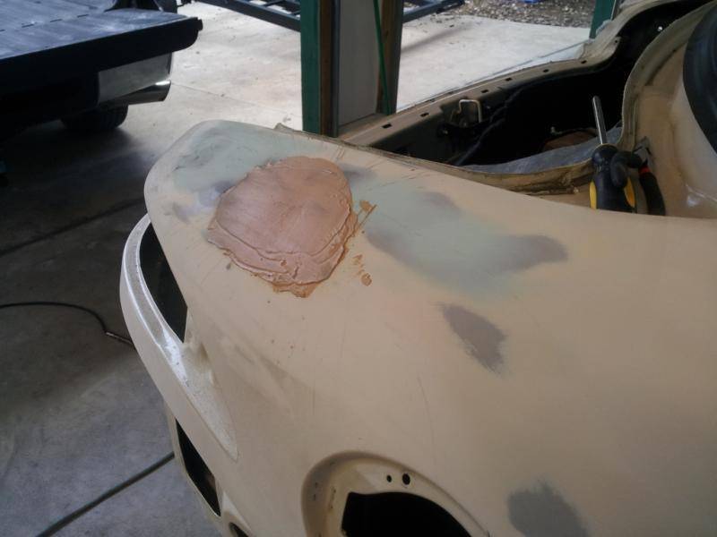

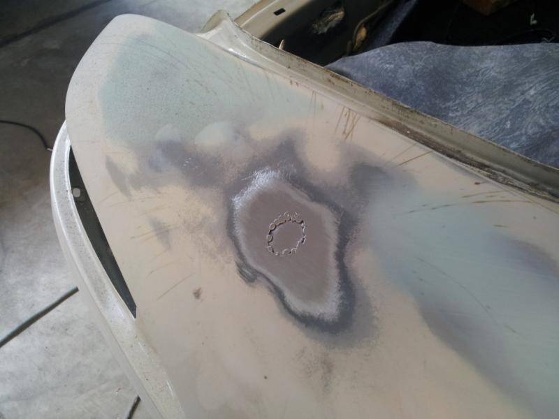

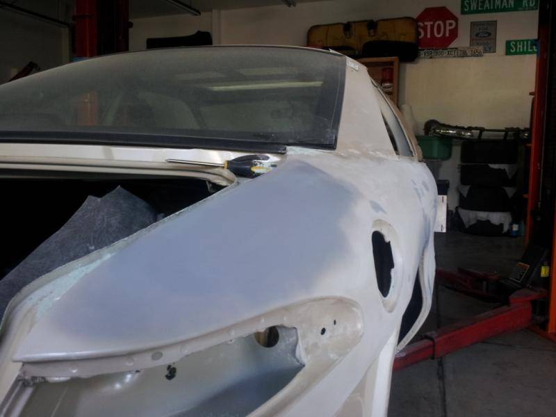

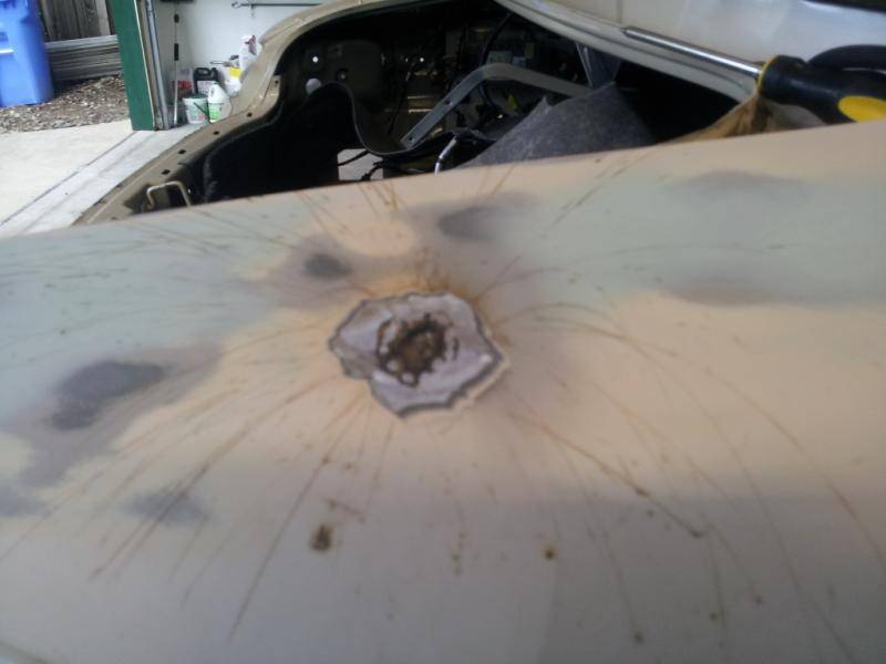

I'm doing it only to shave my gen one antenna hole, I don’t really listen to the radio but I will be hooking the gen II antenna system up for occasional radio use. I just want her to have clean, smooth body and I want my car to look pretty too! :D
This same thing was done on someones car on here. Turned out pretty good but finding pics might be a chore. I have one but it also includes filling in the gas door and moving the filler neck behind the tail light so that it swings open to fill the tank. The antenna was also being deleted too.
Shave the door handles too lol.

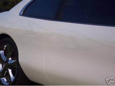

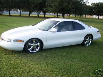

Side moldings and all were shaved. Always liked Rays car. Just not the trunk lid.
Just don't do this. Doesn't look right.How it's done or can be done.
[url]http://www.lincolnvscadillac.com/showpost.php?p=632219&postcount=81[/URL]
Antenna in the glass is the way to go.

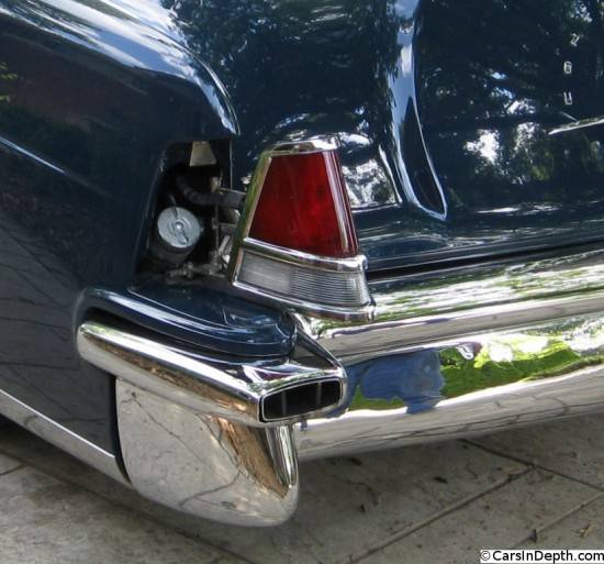

Interesting. That recalls the fuel filler neck on the '55-'57 Continental Mark II:) On that car, the filler neck was located behind the d/s tail light. Now just make the exhaust exit through holes cut in the rear bumper and you'd have another homage to the granddaddy of all Marks:D
