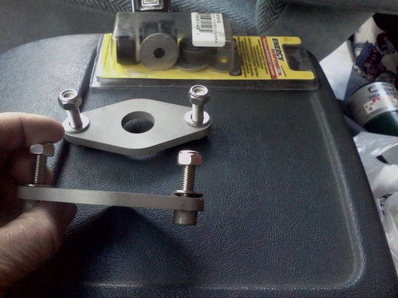

i used the stock mounts, burned off the rubber, and just cut on the metal mount until it was flat and bolted it back in.
I also use the above shown mounts with the Sensatracs. Bought mine for $50 from Jamie but they are identical, except mine were black. I used the bushings that came with the shocks. I have been on them for over two years now and I could probably use some better bushings. I hear a creaking sound sometimes but anything is better than that damn clunking....
They are similar, but not the same...
There's a reason why yours are painted black...mine aren't painted, because they'll never rust. ;)
Will these stop the creaking sound I hear from back there? I know it's the rear shock bushings doing it. If they'll stop it, I'll gettem right now.
Just so you know, the O.D. of the nipple on those E.S. bushings are .875" and the center hole I.D. of your mounts are most likely .790".
In order to use those bushings with your mounts, you'll either need the center holes drilled larger or the nipples shaved smaller to fit.
Along with those, you'll also need a couple washers to go on either side of the bushings to keep them in check. I might have some extra washers, but I'm not sure.
When they were sold to me, they were said to be stainless and painted black to not be so conspicuous but idk. Either way, they have been in now for over two years and no rust but I also don't live in a rust area.
If they do need to be drilled, I have means to a press that can get them to the right diameter needed. It could have just been the washers missing all this time. All I know is that they make a creaking sound, with slow movement. I know the mounts are up there good because they came with washers, lock washers and locking nuts. I have checked them and everything is still tight. Just figured the bushing Monroe gave me sucked.
Does E.S. make a bushing for the .790" hole? If so, I'll just make it all easy and buy that size. If not, it's not a problem to drill. I'm also going to be getting Koni adjustables and putting the Sensatracs back for some other day.

I should have done this long ago! I don't like the factory mounts and will look for... or make something else.
I think I will work on making my own and let you guy's know what I come up with (pic's included).
