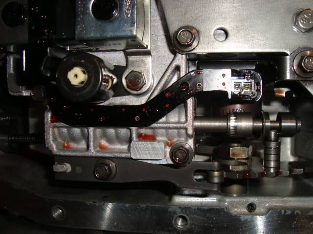

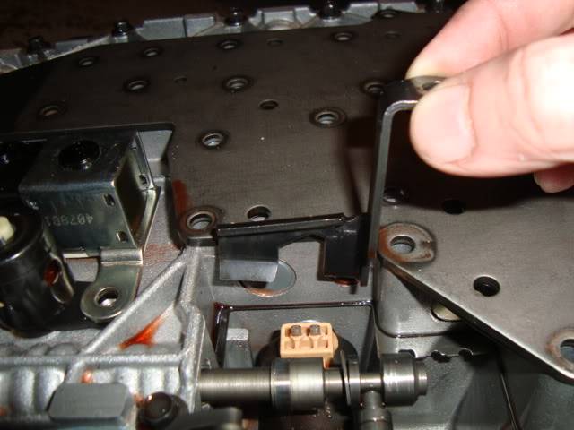

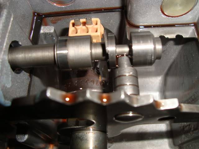

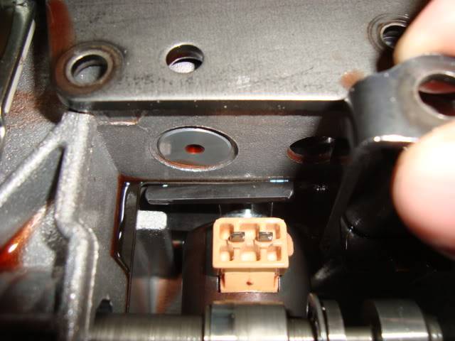

Bill, are you helping with any of this at all or just paying complete shop cost to have it all done? If you are helping, the harness and solenoids can be swapped by yourself while the other person is dealing with your valve body and getting the new gaskets & separator plate in. Your only time consumption is going to be the trans pressure solenoid which requires you to remove the gear selector out of the way to replace that one solenoid. After that, it's all down hill from there. That 98 black plastic wiring harness just snaps right out and all the solenoids from the 96 pop right in place with the exception of maybe 15 minutes of time doing the pressure solenoid which is easy but does take a little bit of time to do.
Some pics below when I was doing my pressure solenoid.
Once the solenoids are in place, your harness from the 96 just plugs in like a plug in the wall. Nothing to it. Takes every bit of 2 minutes to plug it into all solenoids. Try testing the solenoids to make sure they're reading right. If they aren't bad, don't go and blow money on new ones. It's unlikely that any are bad. Just my thoughts.

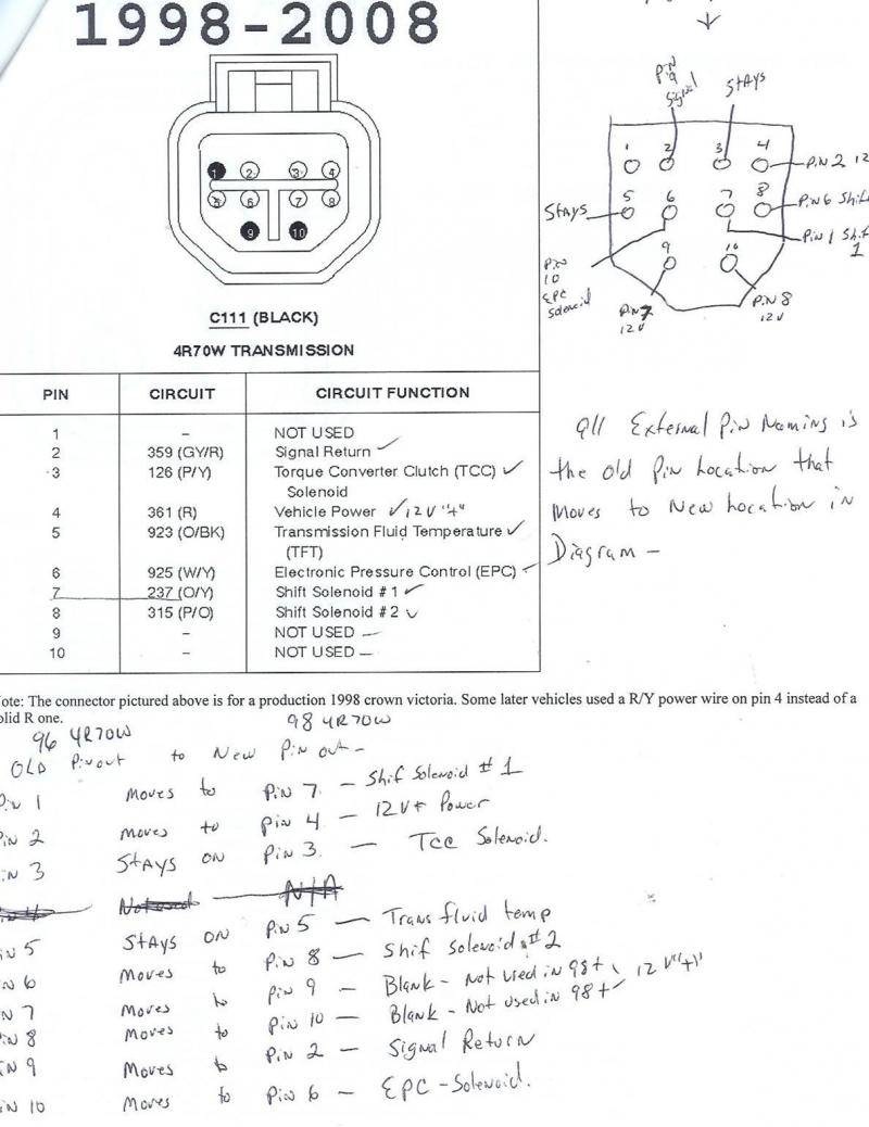

Updated Pinout for 96 to 98 Trans 4R70W
below is an image attached for the pinout.
This is just incase someone either wants to correct me or maybe can use this for their reference.:eek:
