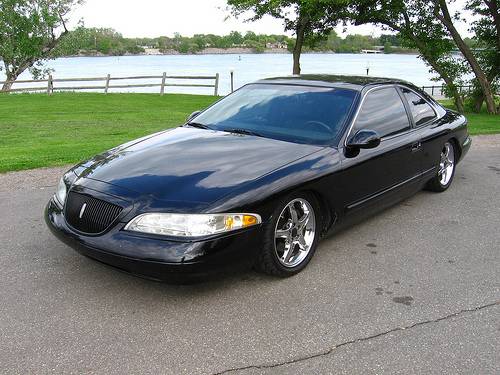

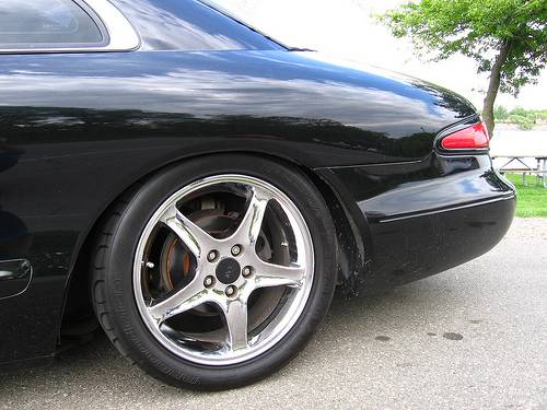

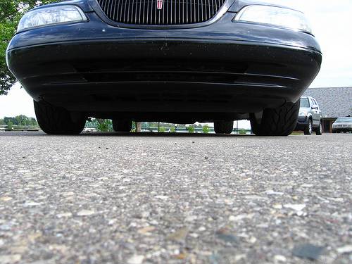

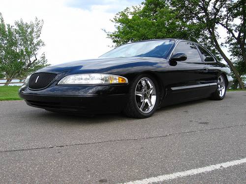

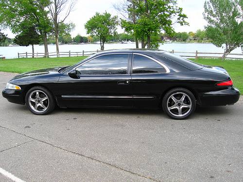

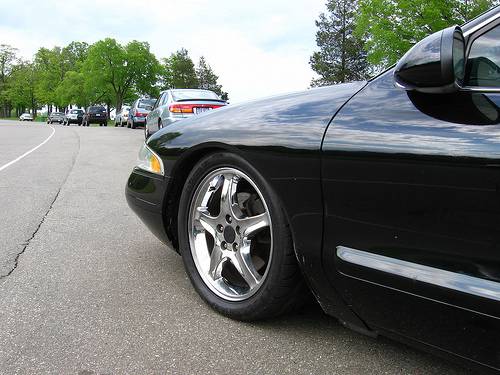

Update, just got the switch installed, it took me 2 hours but thats because I didn't actually have a crimping tool, and ended up having to hard wire a couple wires instead of using the provided spades. It looks awesome, I'm gonna get it all put back together and head out to the local park and get some pictures.

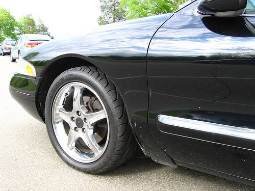

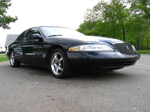

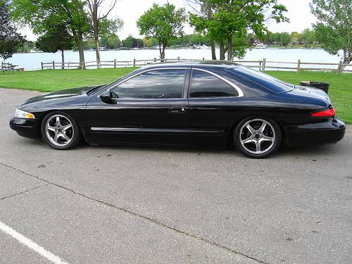

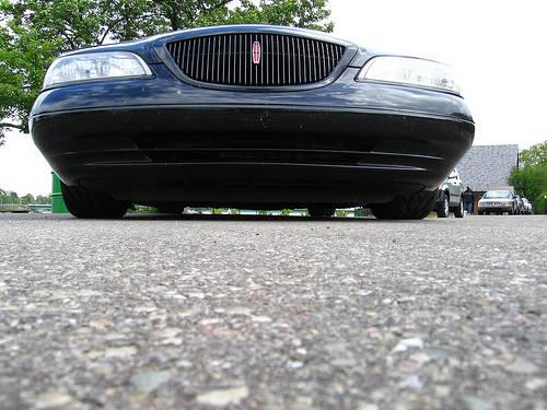

Ok, got some pics. The car is dirty, I just got home from vacation yesterday and the switch was here waiting for me.
First are at normal height.
And dropped.
Muahahahahahahaha!
I've done it! I've created a monster! :gr_devil: :headbang:
Ok, so I recreated it, but it looks good man, real good!
Thanks, I love it. I don't know how you or Ray ever got this thing made. Electrical stuff confuses the crap out of me.
Oh by the way, the colors of my wires ended up all being the same as in your directions. Mines a 98.

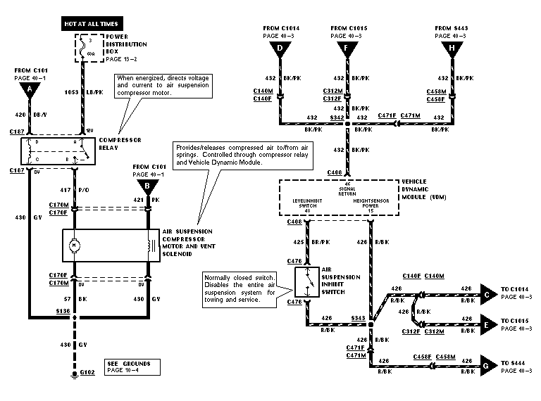

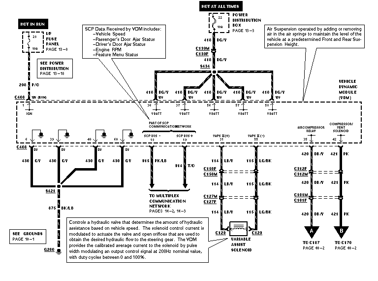

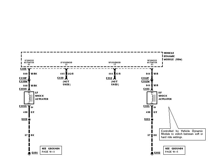

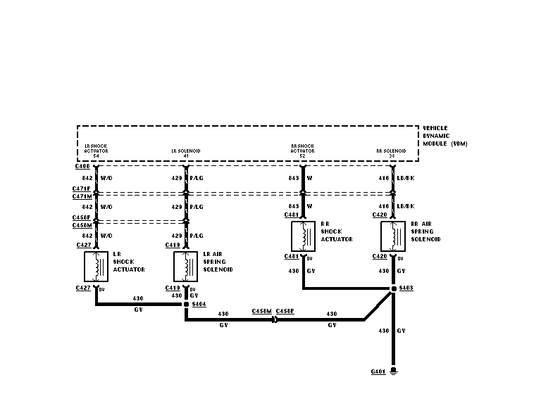

looks good jbird, good follow through 96, ill shoot you some diag's for a 97 conti.
*edit* ok well i cant attach photos in pm's so heres the diagrams

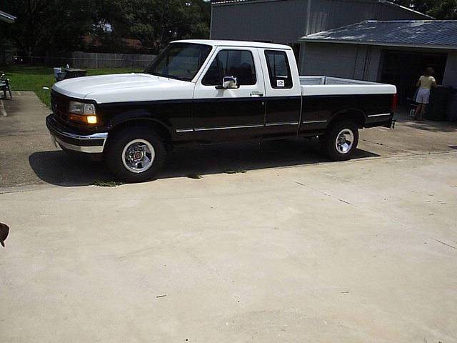

So then I wanted my '94 F-150 to match.
Before: [Don't really have any good pix's from before]
After:
So I'm figuring on painting the Lincoln to match.
