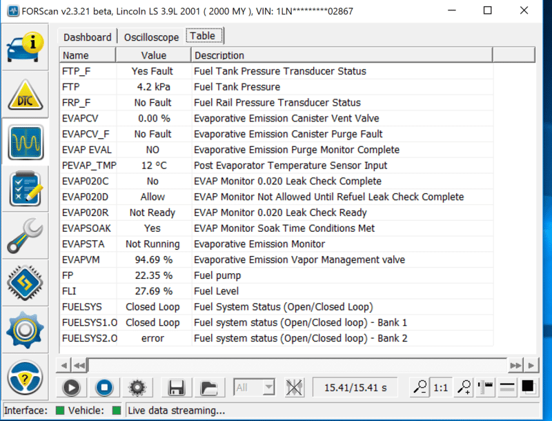

      I went out and looked on the drivers side and I can now get access to the harness it's still tight but he was able to position it so that it can be tested. So I am looking around my house I could have swore I had a meter. Then what do I need to test myself exactly since I should have access to the harness. I am not good at all with electrical stuff so please be patient with me! Also ran a few tests with Forscan

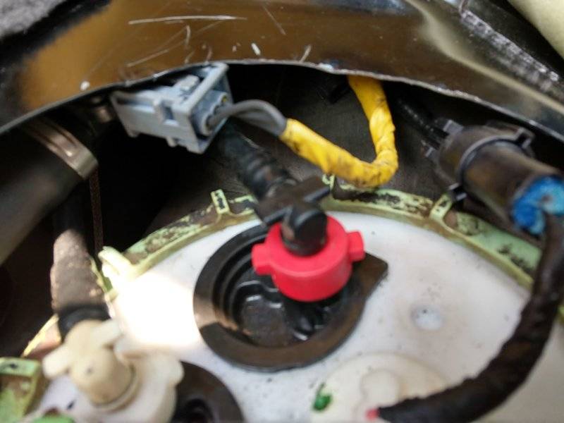

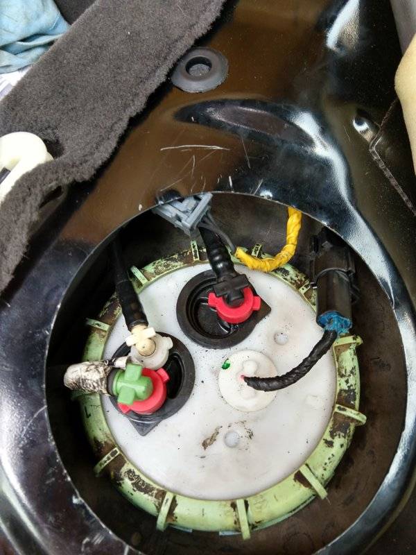

        Just thought I would post a picture so people would have an idea where the FTP sensor and connector actually are in the 00-02 LS. I also assume it's similar in the other models.
        Where you see the Yellow Heat Shrink that is the connector to the FTP sensor. I am not sure if it's like this exactly on the other LS's but mine is easier to see now since I replaced the harness and the FTP sensor.

        My fuel tank Pressure sensor is reading a steady 1.0 when car is at idle in Park I see yours is 4.2 ...was car in Park and at idle in your Forscan Data Photo you posted?

        Yeah it was parked and was at normal idle. And it does not move around with taking the gas cap off nor does it change if accelerating in park. I am hopefully going to have more of an idea what the problem is after tomorrow.
