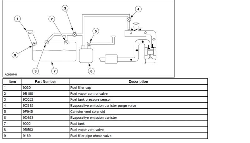

        No, this is not the fuel pressure. It's the fuel tank pressure (FTP) sensor.
        The fuel tank pressure (FTP) sensor:
        • monitors the pressure levels in the fuel tank.
        • communicates the pressure reading to the PCM during the OBD II leak test.
        • is permanently attached to the fuel vapor control valve tube assembly.

          Is FTP incorporated into the electric fuel pump assembly in the tank.I know that on some vehicles it is...just wondering if this is true for the LS also...kinda hard to follow all this...I'm kinda slow sometimes :)

          No, of course not. If it were in the tank, wiring to the sensor would have to pass into the tank. Note that the fuel pump connector only has wires to power the pump and to read the fuel level sender.

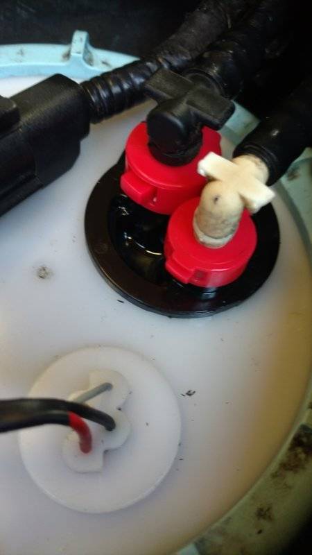

          I did discover a problem this morning the fuel is somehow leaking around the fuel pump for some reason. Obviously I know have to fix this problem ASAP but could it be related to either of the 2 codes I am seeing?

          I am hoping the fuel pump did not get a good seal when it got put back in. I don't see any fuel leaking around the lines. I am thinking it's just leaking when the tank is really full. I am gonna talk to a neighbor where I am at right now they work on cars so hopefully they can work something out for me. Cause I could not even smell it so I would assume the gas has been there for days. And the tank is low on fuel right now which is a very good thing considering.

          I've had to work on this fuel pump extensively ...first and formost make sure the O ring gasket is properly seated before screwing on the blue ring...is this the original fuel pump assembly module?
