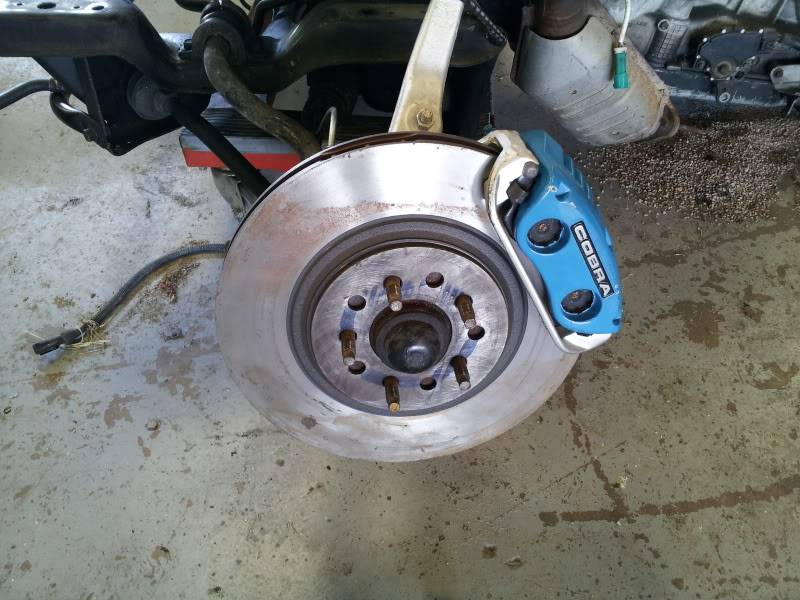

I say if you want the Cobra brakes, and the wheels, you might as well go all the way.
Doing the full swap might be a little more expensive up front, but it'll be cheaper in the long run. You won't have to worry about (depending on which way you go) hub-centric rings, adapters, getting rotors drilled to a different bolt pattern, or drilling hubs.
My motto: Do it right, and do it once.

I have hub swapped/cobra braked almost every MN-12/FN-10 I have owned. These car just do not have enough brake from the factory and I don't want to deal with drilling rotors or having hubcentric rings on the back to get better brakes.

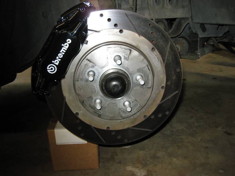

That's why I'm looking at running.......03-04 Cobra brakes. Any idea if the Saleen 4 piston calipers fit as well??

There's nothing wrong with the Speedstars, but if you want to do Cobra brakes, do the hub swap, and get some Mustang Speedstars for cheaper...
2000 Cobra R brakes will work, just need some different wheels. Speedstars won't work...

For those who think the stock brake calipers are not adequate. Just get some EBC blue stuff brake pads and EBC brake rotors and it will greatly increase your stopping power. If Horsepower can use it in their 610 HP Project Deep Sleep 97 Thunderbird, we can use them as well, as I know nobody is pushing 610 HP. :shifty:
I think you need to take a ride in a mark with cobra brakes or better then tell me stock is adequate.
i know they aren't adequate. at high speeds, single stop, ok.. two stops, meh. 3 stops, oh my goodness where did the pedal go its on the floor i smell brakes burning holy cow they rotors are warped bad omg.
at least in my experience.
cobra brakes, first stop, good. second stop, good. 3rd stop, good. and on and on.
its not single stops, its repeated stops.
My 13" cobra brakes feels like they should have been factory, i think 14" brakes are "adequate "
