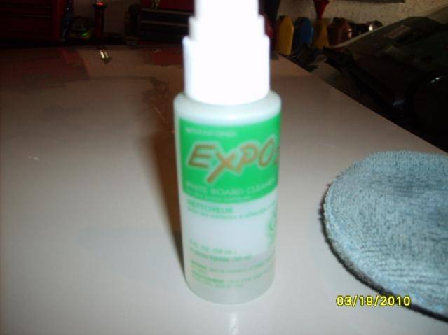

But there is one technique that I have found to be the best of all others. It involves no sweat, work out with a buffer, erase wheel or anything electronic. A while back ago while in the military I tried using different chemicals to removes pinstripes and I saw a bottle of Expo Dry Erase board spray that can be picked up virtually any where for cheap.

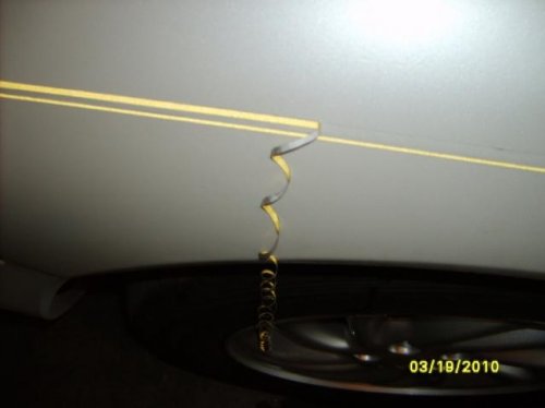

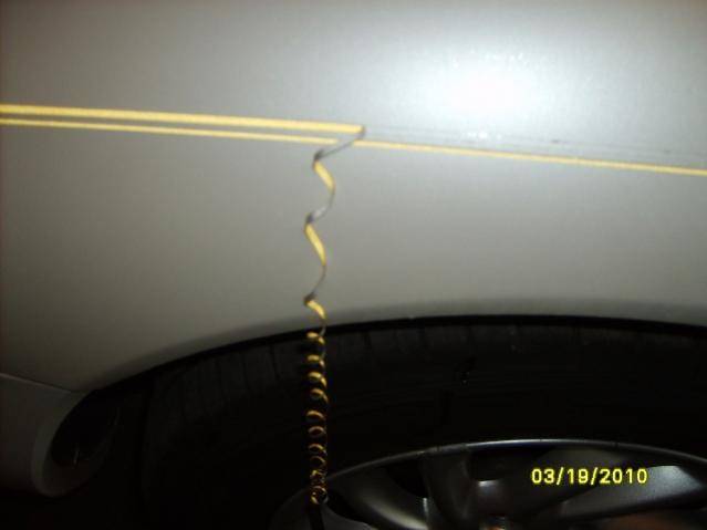

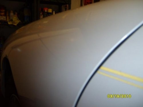

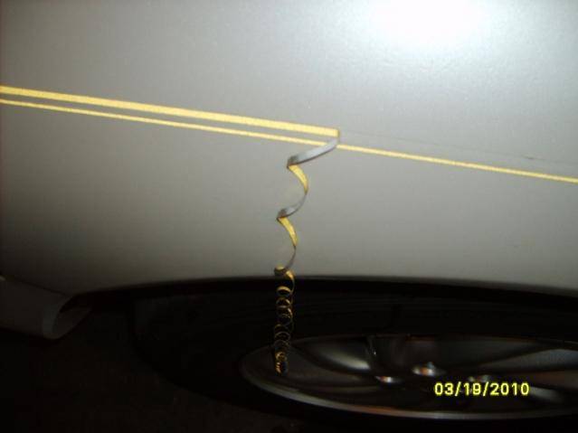

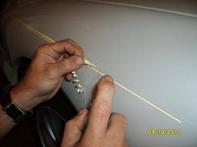

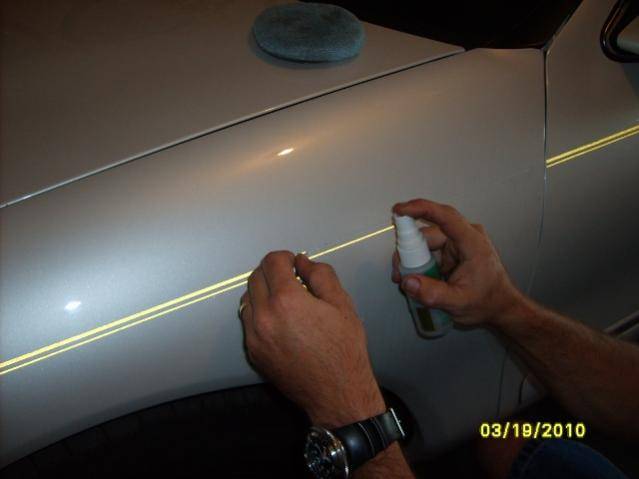

What I found is if you just peel up one end to be able to grab with one hand, and with the other start to spray the Expo Dry Erase fluid bottle in behind the stripe and pull gently at the same time and continue till it comes off in one stripe. It does not damage paint and I have never had to go behind and buff or was other than taking a wet hand buff pad and wipe off the dirt that was edged or behind the stripe.

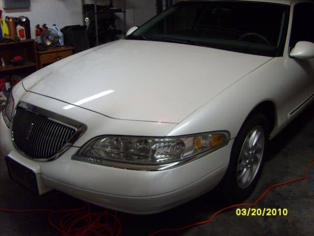

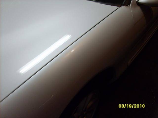

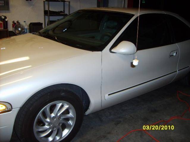

It is the easiest and less energy producing method to date that I have found. Here is a couple of pics to show you what I am talking about and you can see that it comes off in one stripe without tearing if you are gentle. As you can see this is a 14 yr old vehicle with stock stripes coming off with ease and no mess or buffing required. But do not do this in the direct sun light, do it in the garage at normal temp.

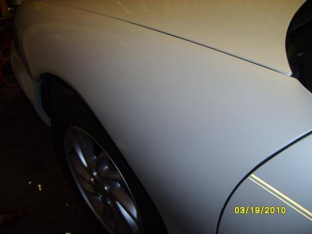

As you can see the only thing left is the dirt from behind or edged from the pinstripe. One wipe and it is gone.
This is one fender done in about 10 minutes, and all it took was a wipe down with the terry cloth pad and no telling it was there.

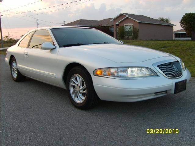

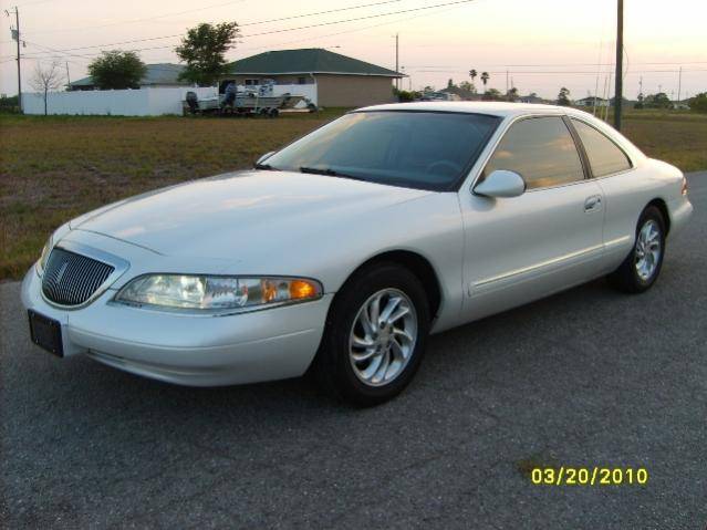

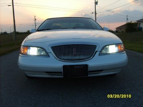

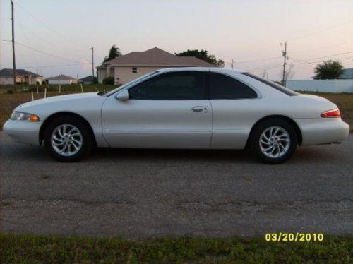

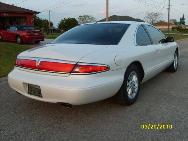

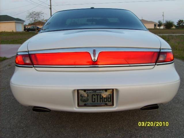

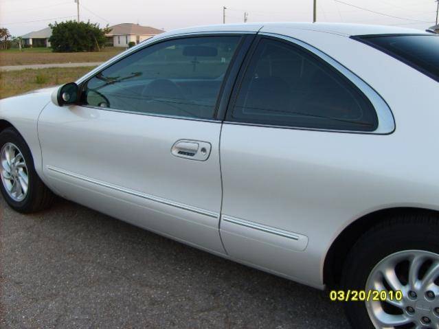

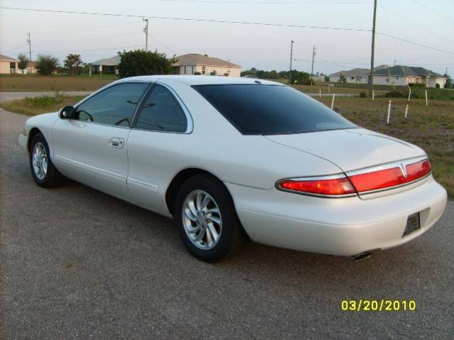

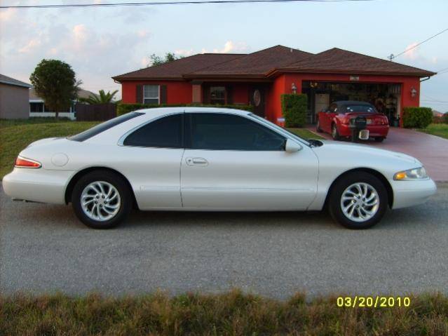

Well here it is without the stripes and clean, what a difference it looks so much better.

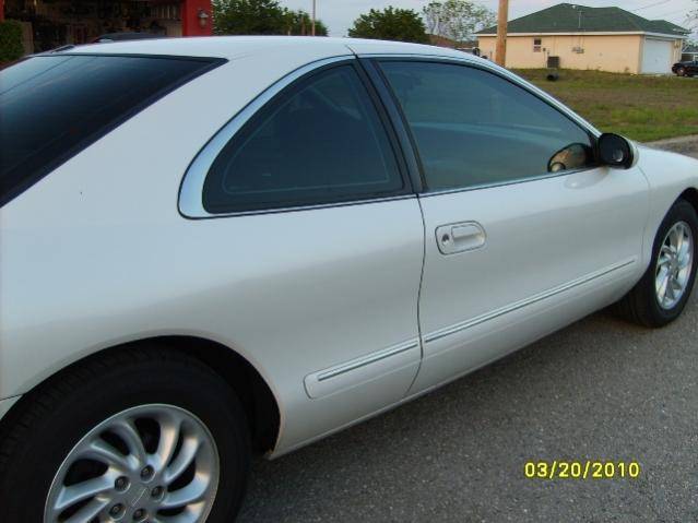

I took all the lettering off and all the decals I had on the side windows, looks clean.
It took me awhile to grasp the look after the driver side was done. I kept looking at it and saying it looks kinda weird without them. Then after this morning and finishing it up after I got back from the airport in Ft Lauderdale, I took it outside and wow, I thought it was a whole different car. I can not believe that those pinstripes took the appeal away from the body so much. And with the letters gone from the rear taillight section, made it look even better, and of course the clay bar and wax job:D
Your car looks exactly like mine when I first got it. Since then, I have also removed the pin stripe and put on Octastars. The car looks so much better without the pin stripe lines.
