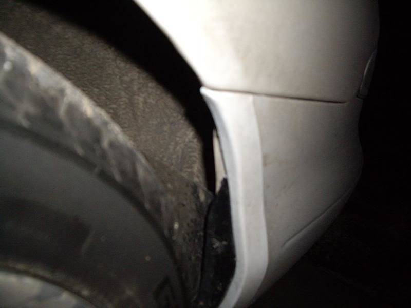

i got 285-35-18's on the back of my 97, but i am buying 4 new tires in a few weeks for it, my fronts are 245-40-18, i want 255-40 in the front and i want to see if a 295-35 will fit in the rear. we'll see!
Jamie, you can just squeeze a 295 under there I think...... maybe. Figure the tire will be sticing out apx 10 more mm. Looking at what I did to mine I think it can clear. Just roll the fender and cut off the upper bumper screw and trim back that plastic piece a little.
