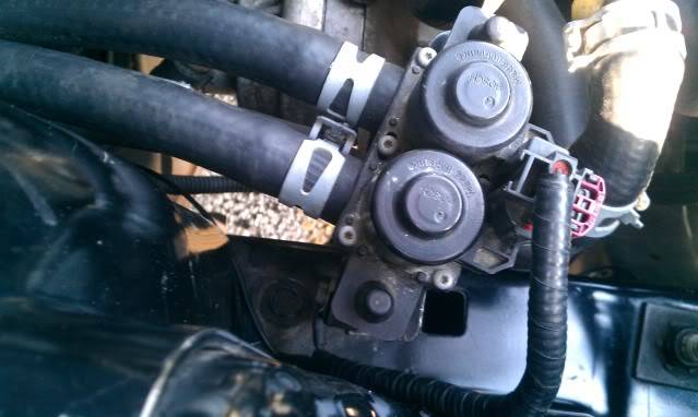

I am actually wiring up a switch to turn the DCC solenoid valves under the hood open or closed from inside the car as we speak. This way I can go from heat to AC with the flip of a switch. No more popping the hood to turn that hot valve!

Ok I got everything wired up so I can now control the factory DCC solenoid with a switch from inside the car. So when I turn the switch on it closes the solenoid valves so that no coolant flows into the heater core and the AC blows cold, and when I turn the switch off it opens the valves and then you have heat. If I want something in the middle I turn on the AC and open the valves to heater core lol.

Here are some pics I took of how I wired it.

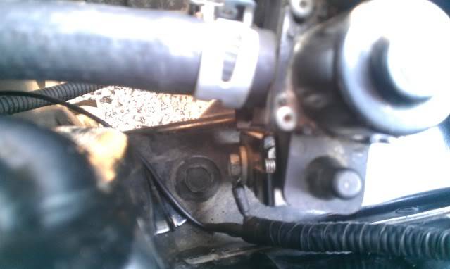

The wire on the right is where I grounded the solenoids. The wire on the left is the power wire going into the car to the switch.

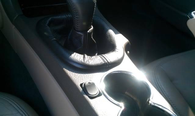

This is the switch that turns on the AC. It is wired to turn on the compressor and the fan.

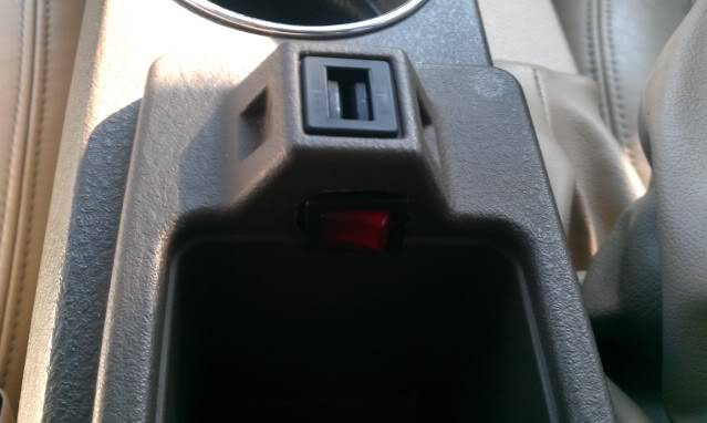

And this is the switch the opens and closes the DCC solenoids.
