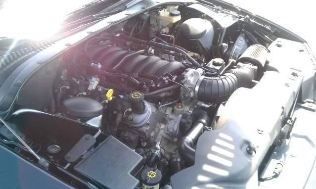

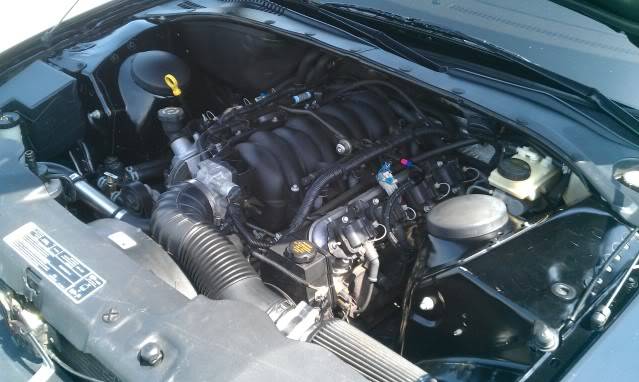

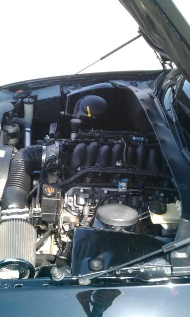

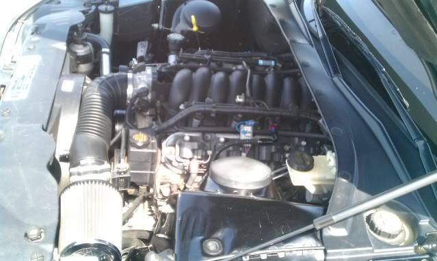

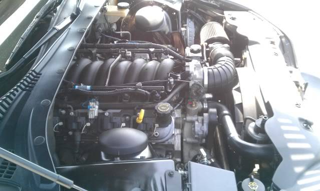

Pics of completed Gen 2 front end upgrade.

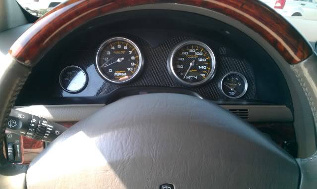

Ok so the things that don't work (I think it's due to the lack of the factory ECU) is the DCC and temp settings. As of now, I have so it's either all heat or all AC. It's on my list of things I want to make work. Also the rear defroster, front wiper defroster, and heated mirrors don't work. Yet another thing on my list, but hasn't been a huge deal. And the gauge cluster WILL NOT work with the swap. My buddy did everything possible to try to get the stock gauges to work, but wasn't possible so it has aftermarket Autometer Carbon Fiber Ultra Lite gauges. Here is a pic of the cluster.
I will probably redo the guages and the carbon fiber mounting panel to something more modern and cleaner looking.
so a/c doesnt work? i didn't quite understand your comment. thanks
so, either all heat, or all AC.
Exactly. The factory DCC solenoid wasn't getting any power, so the default position for the valves is to stay open and let coolant flow freely in and out of the heater core. So for now I have just installed a manual turn valve to let coolant into heater core for heat, or turned off to use AC. I have planned on wiring a switch to the solenoid to control it in the car, but would rather get it to work like factory if possible. Does anybody know if all that stuff that's not working runs through the factory ECU?

yea i see getting the factory climate controls working to be very difficult and just not possible. the easiest would probably to just install a manual valve to be able to adjust the flow to control the amount of heat, this could also be used to control how much AC you have to (might not be the most efficient way of working)
I'm not using any piggyback ECU just the factory LS1. THE CAR IS A 6 speed. Also does have a larger Walbro fuel pump.
I am using the manual coolant valve method already for the heat and AC
