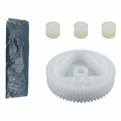

You probably need the nylon bushings inside the motor/transmission - they're a few bucks at your local Napa or Autozone.
It is called Window Lift Motor Gear Kit,
If it was going real slow but not making clicking/grinding sounds then the motor has worn out. Just delt with this on Sappers car. No gear problems, motors just got weak. The motors work when pulled off still but not enough grunt to power the window up.
Get a new one off ebay or from Max or from Rockauto. Comes with a new gearset and all. Second gen motors are faster too.
