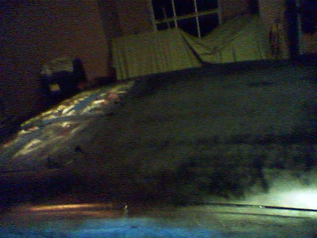

you should clear it first about 2-4 layers then wet sand
Agreed. I never wet sanded the paint when I done it. I cleared it first and then let it cure out for a good 5 days.
When you spray the clear, you might see some foggy white spots, don't worry, it will dry clear. If you see an orange peel look, it will come out when you wet sand.
When you wet sand, it's going to look foggy. If you use the medium cut stuff that I showed you or something of the like, the foggy look is going to start shining.
Use a scratch and swirl remover next and then you'll really see the shine coming through and finally when it's all slick, use your favorite wax to finish it off.

my trunk and hood
yuck huh

That trunk lid would be easy to do. I would take the light bar out and only do the top section above where the light goes and up on top. The hood could be done on that one spot if you could blend. I done my passenger door on a spot that big and it blended in after some careful wet sanding to get the paint & clear I sprayed and the original clear to blend without showing a line.
I also done my rear bumper cover completely. It turned out slick too. Even after the fire, it's still slick except where I used a truck to push it in the back yard. Below is the link where I did that. One of the pics you can see orange peel but after wet sanding and buffing, that all came out like new.
