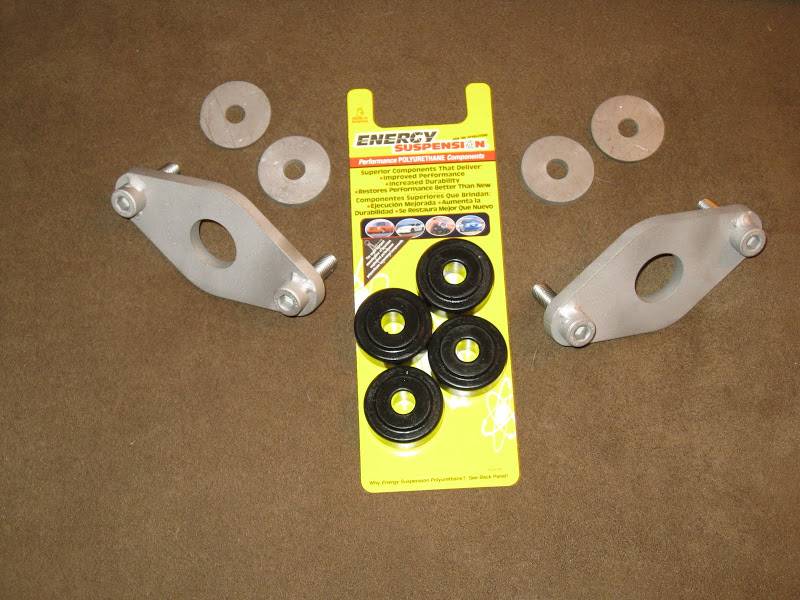

Need a set of these?
I've only got a couple sets left from the last run of them. It might be a little while before I get another run together...

Those mounts look really nice. I'd be interested if I had the money to spend right now. Fingers crossed you still have them for a little while.
