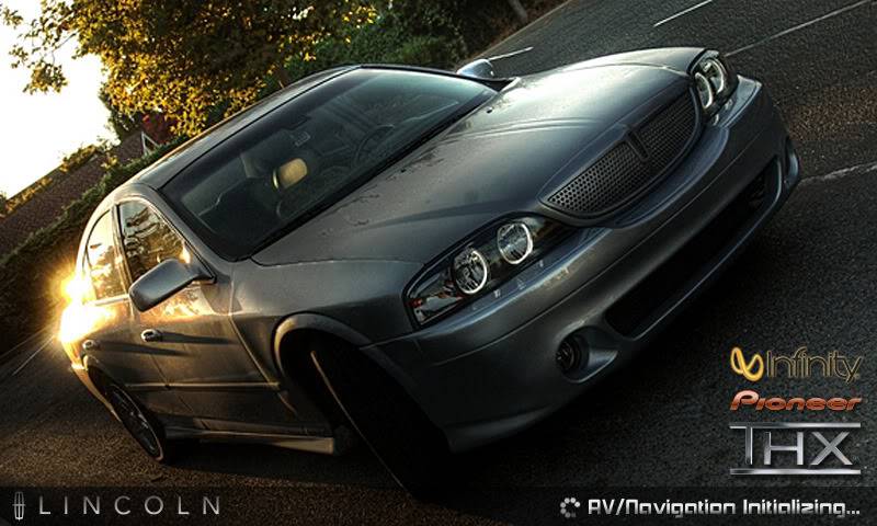

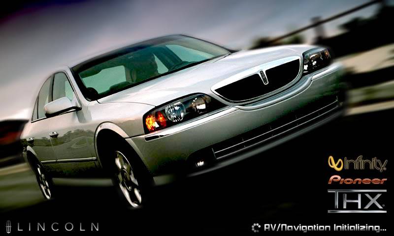

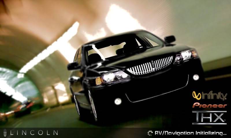

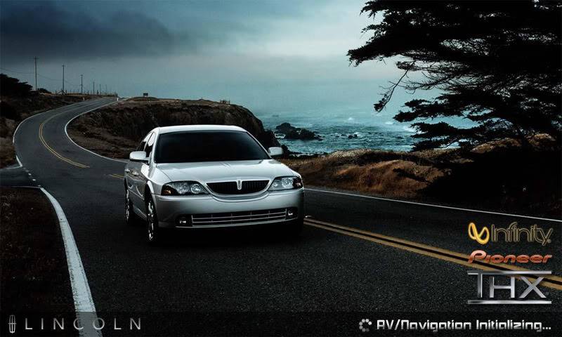

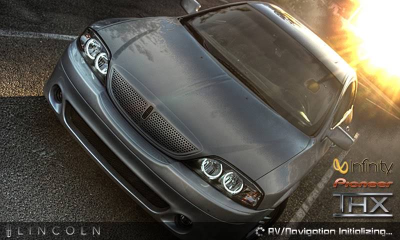

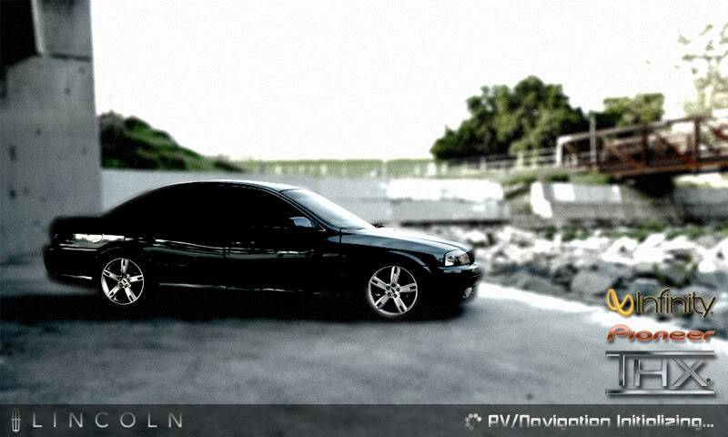

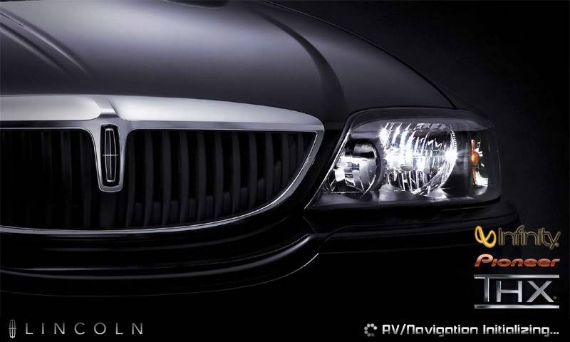

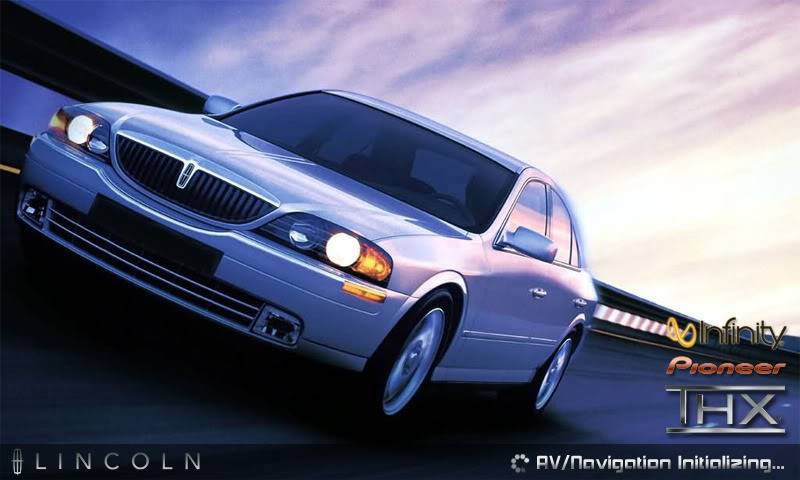

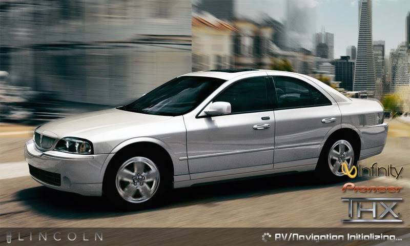

Here are some splashscreens I made for my Z110BT. Some of them might be familiar - coming soon, picwhore... I mean pektel's LS :D
