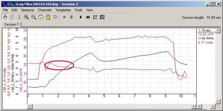

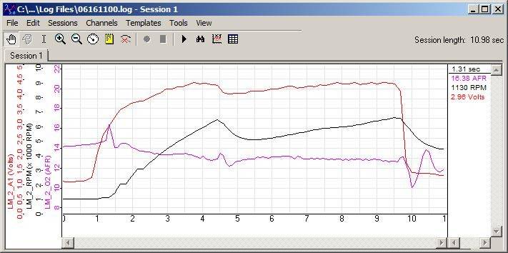

From a bit (:eek:) of reading I've been doing in the past few hours, my guess is that I may have caused it by changing the manifold volume to 10 (stock Cobra value) from 6.875 (stock Gen 2 Mark VIII), without also changing the transient fuel tables. Theoretically, that would cause not only the tip-in lean spike, but also the rich spikes during the shifts.
I'll find out tomorrow. ;)
Think out loud all you want, I'm looking for any help I can get. ;)
Nope, I haven't logged anything other than what I posted yet.
Changing the Manifold Volume back to the stock value got rid of the lean spike.
1st pic is with Manifold Volume @ 10
2nd pic is with Manifold Volume @ 6.875
Next is lowering the A/F ratio following the initial hit (red circle).
