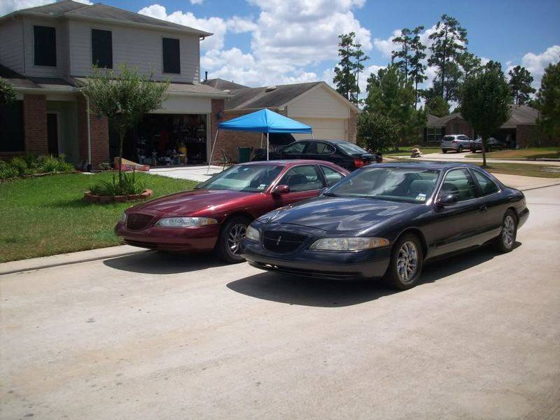

Myco came by today, and I fixed him up with a few parts for his Mark, and to cut the wire to get rid of the Check Air Ride message. That paint job is looking good.
Yes, :p unfortunately he has directional tires, and the tires are mounted on the wrong wheels. I told him he needs to go back to a tire shop, so it may be a bit. He still has to remove the dash and and reconnect the yellow vac line to get the AC to blow correctly.

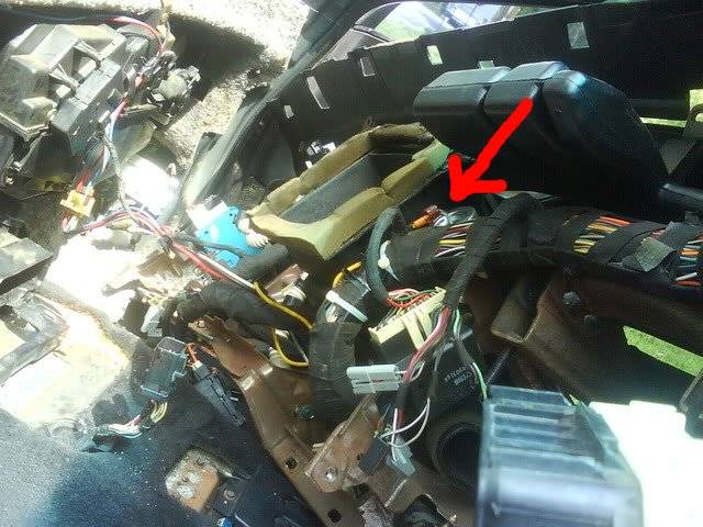

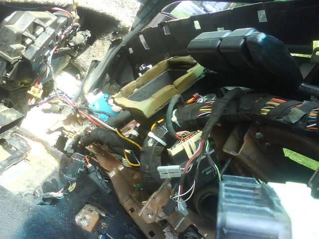

Right now I'm preparing to take the dash out. What exactly am I looking at here? Don't see the yellow vacuum tube.

cannot believe how easy air tools make this! Anyway,
1.One bolt on each side at bottom near door.
2. 2 bolts in L bracket at driver's right knee.
3. two bolts deep in front of shifter.
4. 6 bolts holding steering column up.
5. 6 bolts across top of dash
Do I need to pull anything else from the dash?
