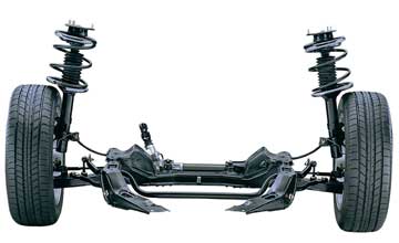

What kind of Mark VIII do you have? If yours has a strut suspension, how did you remove the upper control arm? Did you machine the spindle to attach the strut directly to it? Did you put a bearing cap on top of you coil spring so it wouldn't scrape the shock tower when the steering wheel turns?
My Mark VIII, just like every Mark VIII ever built, has an UPPER AND LOWER CONTROL ARM front suspension. Honestly, how can anyone who has ever worked on a car actually look at the Mark VIII's front suspension and seriously believe it has McPherson struts?
Here's a strut suspension:
And here's an SLA suspension:
See the difference??? Can it be more obvious? The differences between the two types of suspension designs are so blatantly obvious to anyone with eyes and a brain that I can't for the life of me understand why it's even an issue. The Mark VIII DOES NOT HAVE FVCKING STRUTS!!!!!!!!!!!!!!
