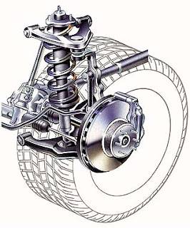

Here's a strut suspension:

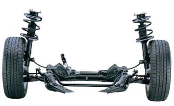

And here's an SLA suspension:
See the difference??? Can it be more obvious? The differences between the two types of suspension designs are so blatantly obvious to anyone with eyes and a brain that I can't for the life of me understand why it's even an issue. The Mark VIII DOES NOT HAVE FVCKING STRUTS!!!!!!!!!!!!!!

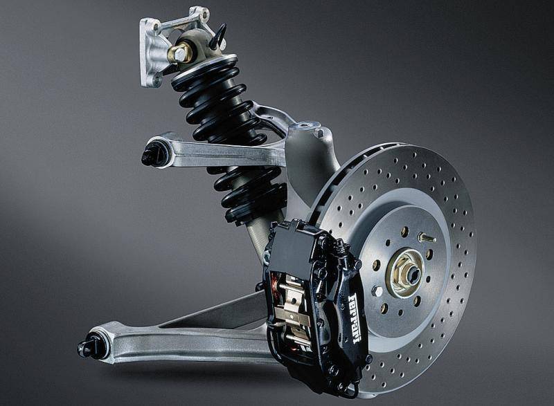

Just for more proof:
Yet another example of an UPPER/LOWER CONTROL ARM (SLA) Design:
More SLA:

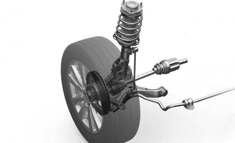

And another strut:
2012-honda-civic-ex-l-sedan-technical-illustration-for-macpherson-strut-front-suspension-photo-3.jpg
Can I get a collective DUH?!?!?!?!
