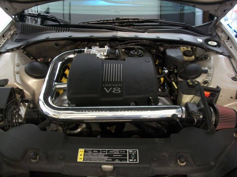

I have installed new Thunderbolt high flow CATs and new o2 sensors. I havent noticed any difference with the new CATs except the absence of the CEL. I am going to do a custom CAT back system with an X-pipe, jones resonators, Magnaflow mufflers and new dual outlet tips.

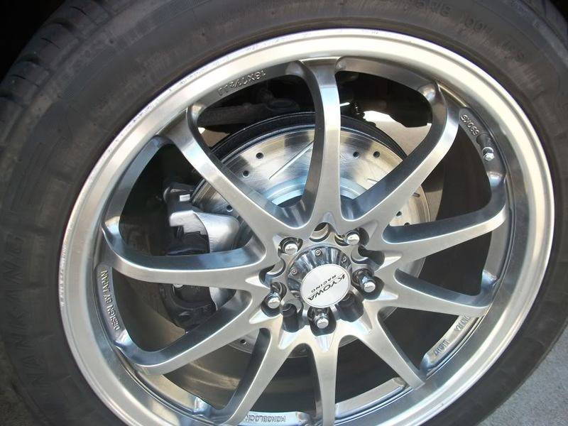

I have finished repairing my Mille Miglia EV-R's and I plan on doing the silver metalizer Plasti-Dip on them. I have watched the vids on DipYourCar.com and I think they will look good and it wont cost a fortune to have them painted.

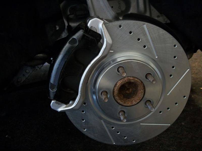

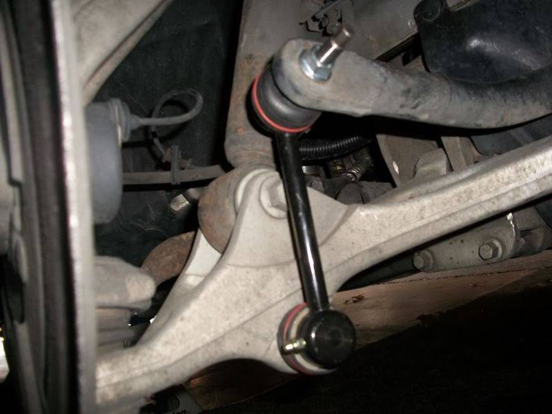

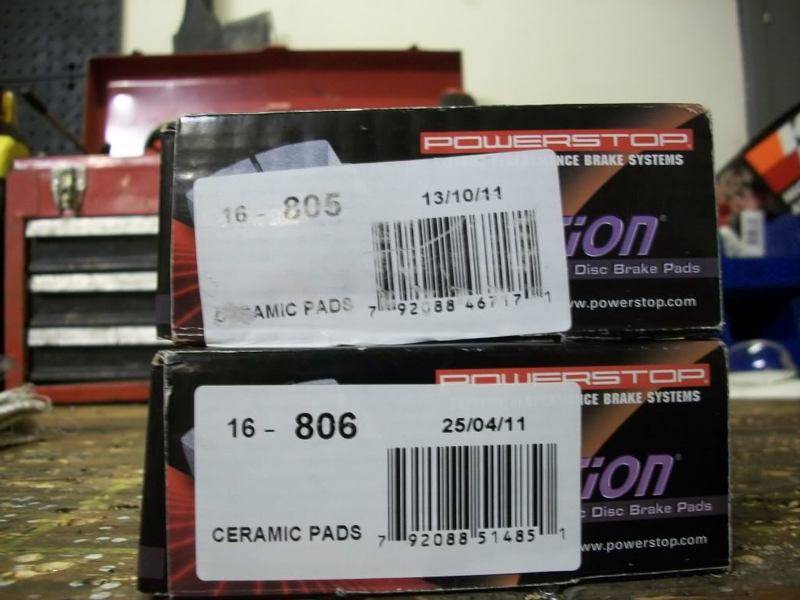

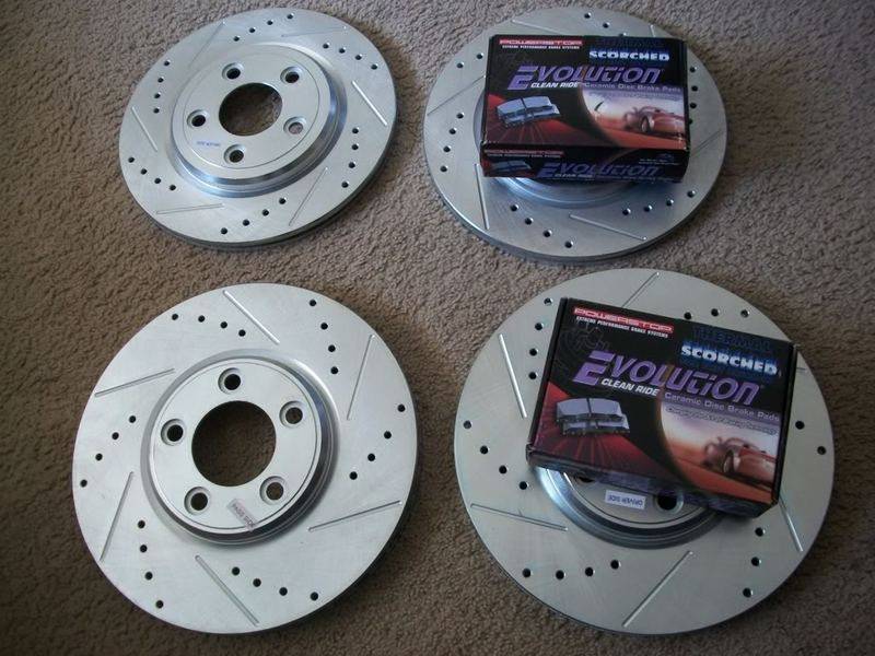

I just ordered my new drilled and slotted brake rotors and ceramic brake pads. Also just ordered new front and rear stabilizer bar links. Next is the tie rod ends (inner and outer) and rear adjust links. After all that the Eibach springs are going on and the suspension will be done.
Next I will be re-installing the TransGo shift kit and PlastiDipping my 19" EV-R's with the silver matalizer kit.

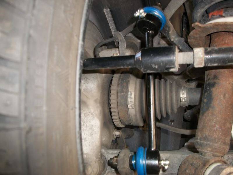

I have installed my new R1 Concept drilled and slotted rotors and Powerstop ceramic pads. Also installed the Deeza front stabilizer bar links and the Mevotech rear stabilizer bar links. Braking and handling have drastically improved. The front and rear stabilizer bar links were shot and one of my front rotors were warped.

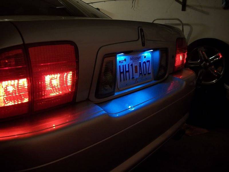

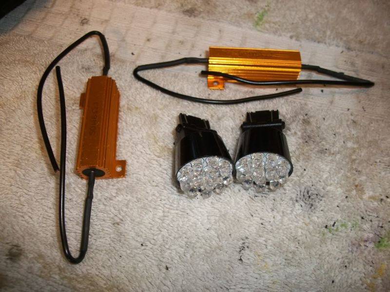

I also installed the rear license plate LED lights. They look awesome. I ordered LED turn signal lights but as of right now I cant get them to work. They stay on constant. I purchased resisitors for them but the wiring diagram that came with them didnt help. I did a little searching and couldn't find a wiring diagram for the front turn signal bulbs, I only found the diagram for the rear brake lights that Alax7 had posted awhile back. I tried that but it didnt work either. My resistors may be the wrong value, they are 50w 6ohm and I read in another thread that someone used 10w 10ohm. Can anyone help me out with how to wire these? I'm going to do more searching tonight and see if I can find what I need.

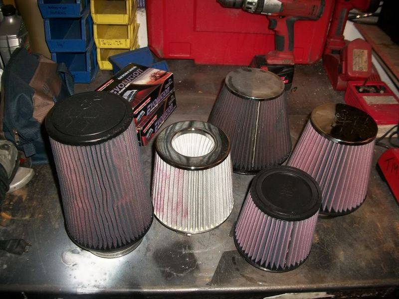

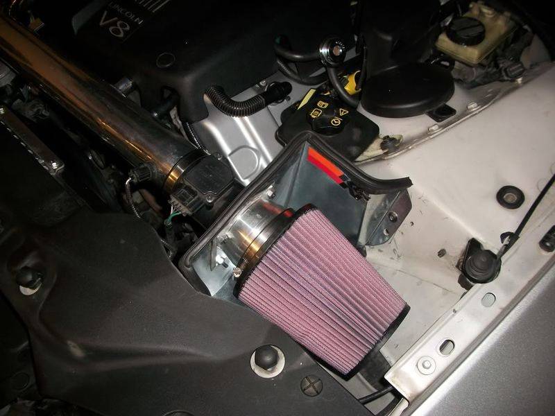

I also installed a new K&N filter (RF-1015). It fits the heatshields for the LSK intake perfectly. I have been thru several filters trying to find the best fit and I have finally found it. I will be posting these results in the 'taking orders for gen1 heatshields' thread.
