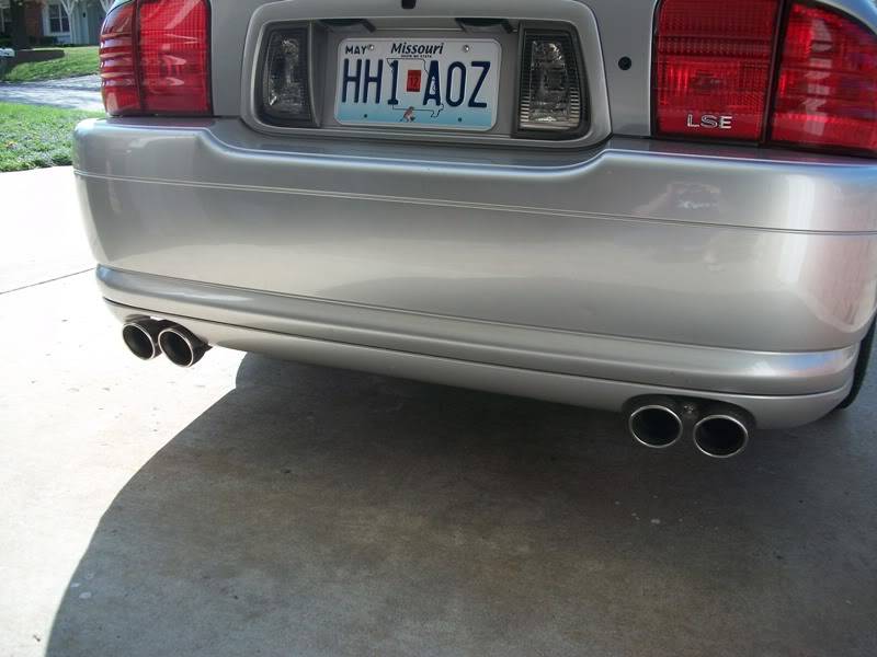

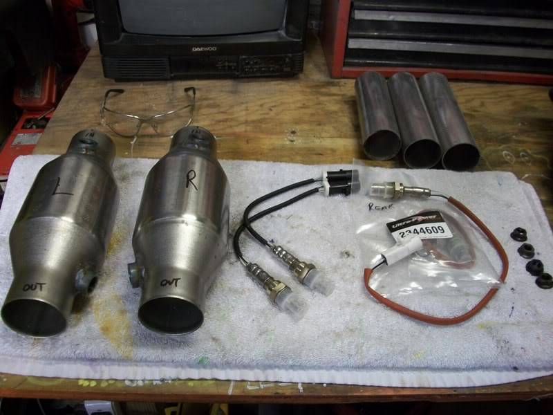

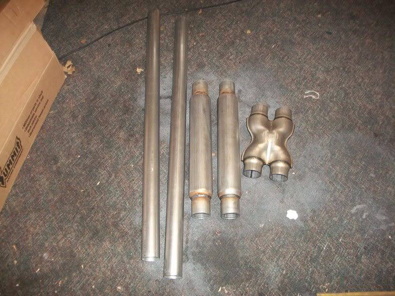

On to better news... I got the 2.5" CATs and back exhaust done the other day. It now consists of 2.25" Thunderbolt high flow CATs, 2.25" to 2.5" reducers, Magnaflow knockoff 2.5" X-pipe into Jones 2.5" x 20" long resonators, custom bent 2.5" pipes into the Magnaflow mufflers with Flow master dual 3.5" chrome tips. It sounds good and definately frees up a few horsepower. I am not 100% happy with the mufflers, I am going to change them eventually but I had them laying around so I used them for now.

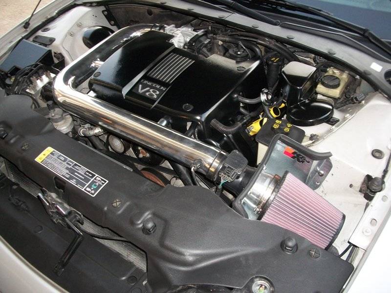

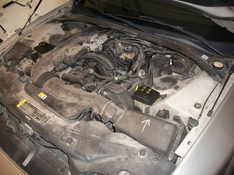

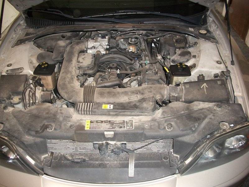

I just thought I would show some then and now pics of the engine bay of my 02 LSE.

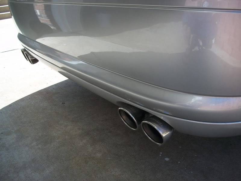

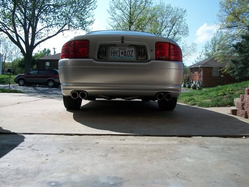

This is my 2.5" custom CATs and back system. Thunderbolt high-flow CATs, Magnaflow 'knockoff' X-pipe, Jones resonators, Magnaflow mufflers, and Flowmaster dual 3.5" chrome tips. I fit and welded everything myself except the pipe from the resonators to the mufflers. I had a local shop bend those pipes for me. I havent made a video yet but it sounds decent.

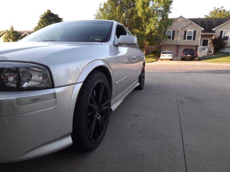

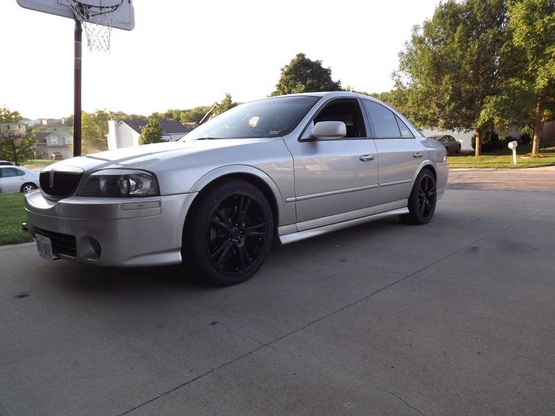

Its been awhile since I updated this thread. I have put the Mille Miglia EVR-s on and they look great. I have the Eibach springs installed in the front. I love the look, a little raked but not too much. It has a very aggresive stance. I have also installed the stainless brake lines in the front. The brakes are now super sensitive, even my girlfriend has noticed that they grab harder than they used to.
