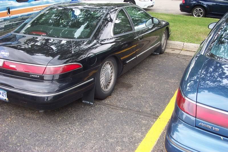

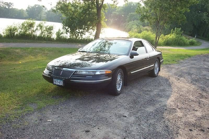

Hey Folks... just wanted to introduce myself, and say Thanks. :)
Last Friday, the "luckiest" thing that has EVER happened to me transpired just about noontime.
I stopped at a yard sale because I spotted a piece of lawn furniture I thought my wife might like... I was late and almost kept going, but turned around and went back anyway. After I paid the guy for it (a couch-size metal "glider"), I spotted a very dusty black car in the back yard with big splotches in the paint, but with very sexy lines from what I could see of it, parked between two old pickup trucks. Asked the guy about it and when he told me what it was, I perked up. He asked if I wanted to look at it... "of course!"
He got the keys, said it was for sale, and my heartbeat went up a little... And when he opened the door and I saw the interior, I was bowled over... spotless! Then when he cranked it up I immediately fell hopelessly in love (but tried not to show it of course :) ).
I was driving my work van at the time, and told him I'd have to sell my current personal vehicle to be able to buy it. He asked what it was... one thing let to another, I went and got my car for him to look at, and before I knew it we agreed to a straight title-swap.
There are only two things wrong with this beauty:
1) The paint... the car spent years under a car cover and has big splotches on the nose, top and trunk lid where the clearcoat is peeling away from being rubbed so much for so long. I can deal with this for a while until I can swing a top-notch paint job.
2) The transmission/drive train had a shutter/skipping feeling under certain driving conditions. Thanks to the thread here, Transmission Dying?, I feel sure I now have the answer to that problem... the torque converter is not fully locking up. I'll change the fluid and filter ASAP, and see if that fixes it.
So here she is, after a detail washjob and a little TLC...
(My last name starts with "Mc")... hence, I give you:
The 1994 Lincoln McMk VIII :D

WOW! I love your story! It's amazing how nice it looks. Please, more pictures. We are pictureholics on this forum! :D & expect plenty of them! You will find all the help you need on this site. Welcome home & conrgats on the new car!
