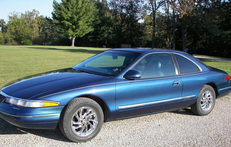

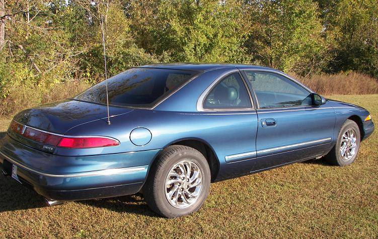

Do you have any pictures of your 93? i jut want to check out the stance.
I have the arnott kit on my 98 , and the front springs are too soft for me. im going to try the monroe kit.
Here you go...

A mechanic friend of mine suggested the same method you posted. Use a jack and unbolt everything.
I thought long and hard about it, but in the end, I didn't have the stones to try it.
Yup. Not nearly as good looking as when I bought it.
The gravel driveway and the crushed stone roads around here have not been kind. I try to keep it looking decent, but its never gonna look as good as it did right after you wet-sanded it.
Since I bought it, I've converted it to coils, replaced the grille and did a J-Mod.

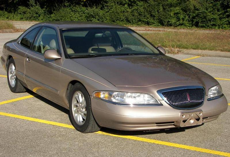

And for comparisons sake, here's my 97 with the lowered kit from American Air Suspension
i know this is off topic but what color is your car, thats not champaign is it? ive never seen that color...
