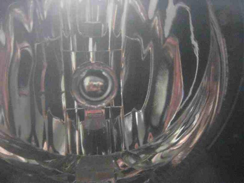

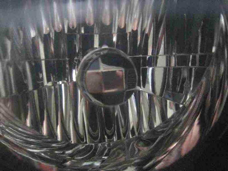

Long_Island_LS please ignore this since you already know everything without having ever seen an LS factory HID assembly.
For the rest of you who might be wondering, here are some pictures of the reflectors. First is the reflector on the HID assembly, and second is the reflector on the halogen assembly. The pictures aren't very good, but you can see the different patterns of the reflectors. What you can't tell, since the pictures are 2D and not 3D, is that the reflectors are slightly different shapes as well. The difference in the bulb shield is pretty clear though.
The pictures didn't post. They're too big. Here they are at low quality.

I don't post random thoughts either. I do have both assemblies, and clearly you don't. They are different. The reflector is different. Also, it is impossible to design one assembly that is legal for both bulb types. The light comes out of the HID bulb at a different point and in a different spread pattern than it does for the halogen bulb. This is why all HID refit kits are illegal for street use in the USA or most/all of Europe.
The ballast from E-bay is not stock, of course it would fit the halogen harness.
The plastic housing does not equal the reflector.
I never said that every single part on the assembly is different. Only some of them are different. That makes the "assembly" different. No two ways about it. It be the same as arguing that the V6 LS is exactly the same as the V8 LS because the both have the same hood.
Go and get a real HID factory assembly and take it apart and you will see what I mean. Or maybe you are too invested in being wrong to do that now.
Let me say this one more time. The reflector is different. You don't even have a HID assembly to look at, but yet you some how just know that it isn't.
If you are going to use that kind of logic, then I guess I am wasting my time here!
Are you kidding me?
The first pic, the one that says the wire probably goes here, the wire dont go there. What wire would go there? Its a breather, I have one on my Gen one headlight unit!
Look next to the high beam, it has one also!
Look a the way the bowls are ribbed in those pics. That defines the difference.
