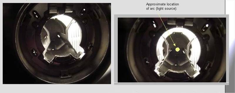

There is a difference in the housings. Not sure about in the reflector bowl, but there definitely is a difference in the shield. The halogen shield is just a cap so you can't see the bulb. The HID shield prevents a lot of the light from hitting the bottom of the bowl, thus preventing the terrible glare. I'll find a pic.
I'm doing HID shields right now. I just made them too big at first. I need to trim them down.

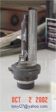

Here's a pic of a stock HID shield:
Mine are way more basic than that. Similar to this design, but mine are mounted in the housing, not on the bulb. And my bulb is not painted. The shield should go under the bulb when installed:

Wouldn't happen to have pictures that show the differences would you?
Or actually are the two pictures I've attached a good example of the differences?
