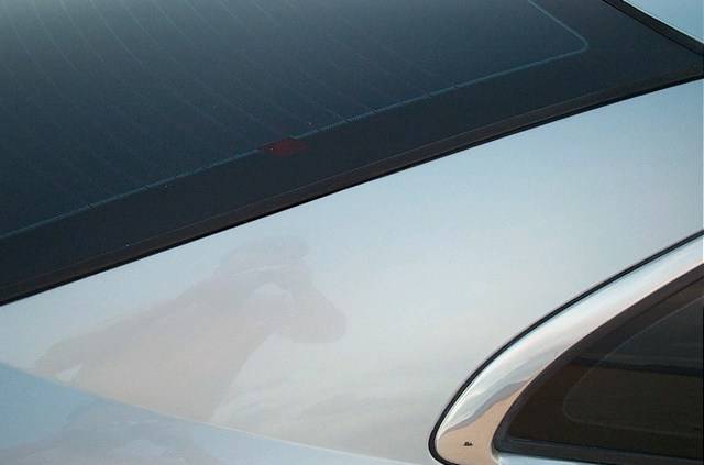

I cut mine 4-5 years ago and people thought I was crazy, untill they saw it and saw how good it actually looked.
Here is a pic of a trimmed one...
Certainly looks like you did a 'trim' job alright.
How exactly did you do it, with a utility knife or ? Put anything underneath to protect paint? How wide did you leave it? thx.
